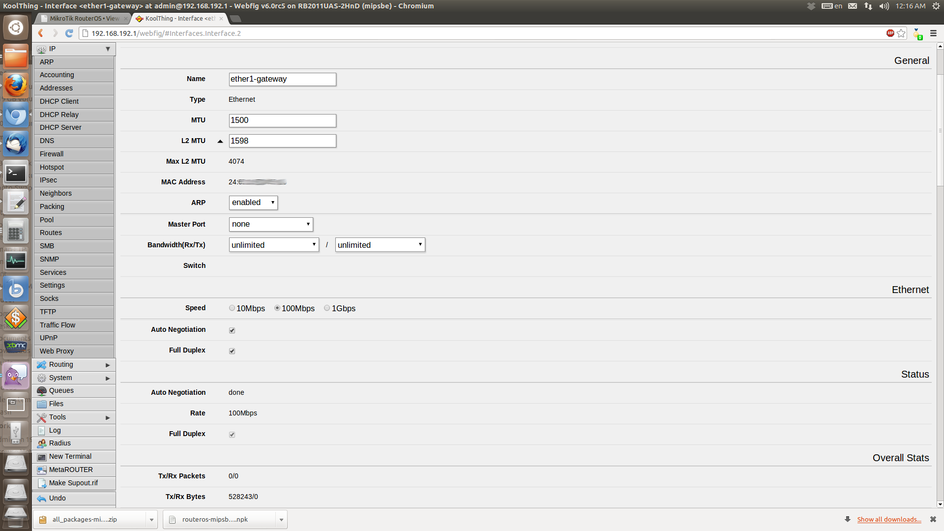

Hmm thats odd.. I have mine connected on ether1 but it’s set at 100Mbit.
Also did you set the time correctly? In my configuration that was the deal breaker for me..
pppoe didn’t connect at first, but when I set the time and date correctly it was fixed.
Good that it’s running now, but it shouldn’t be a problem on ether1.
But the second internal switch is also fine.. The WAN speed doesn’t exceed 96Mbit anyway.

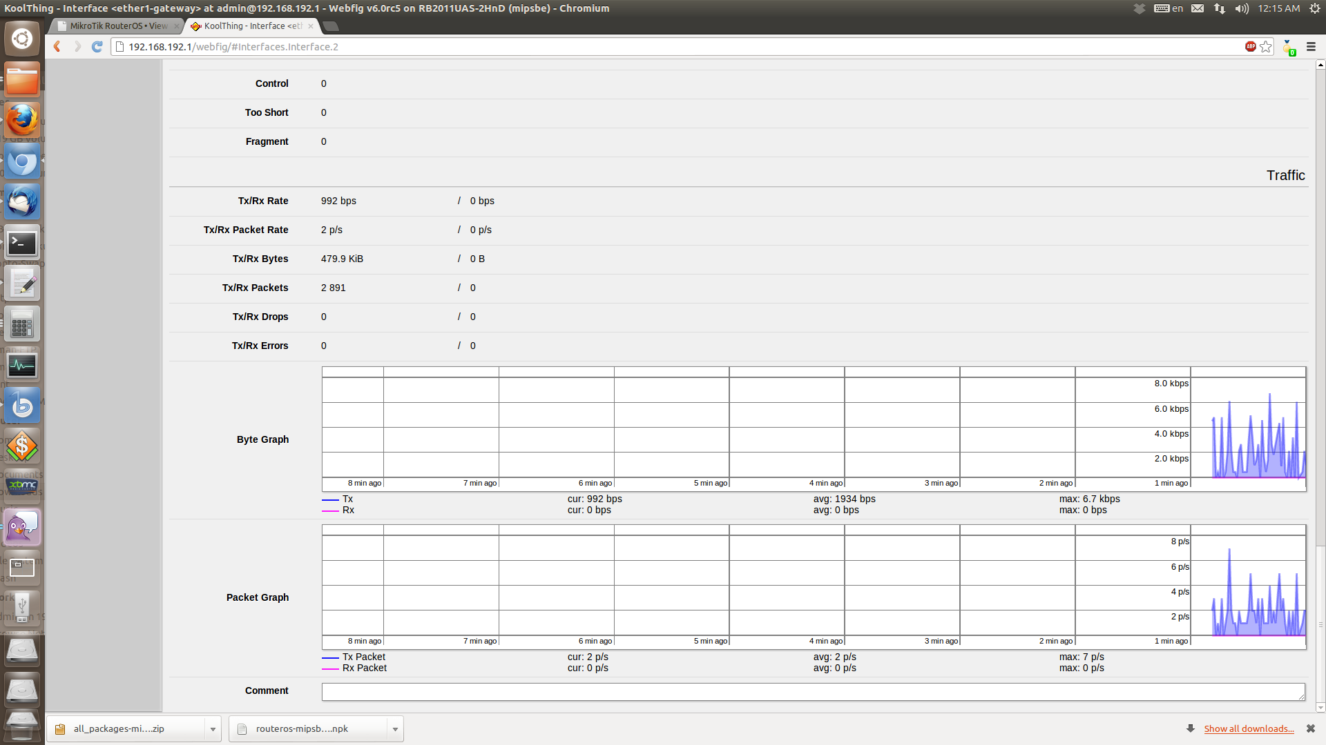

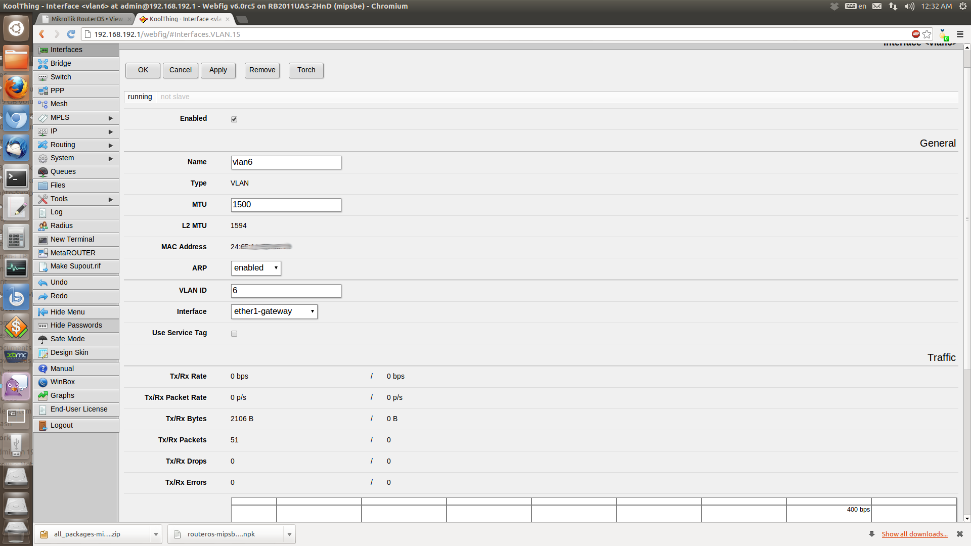

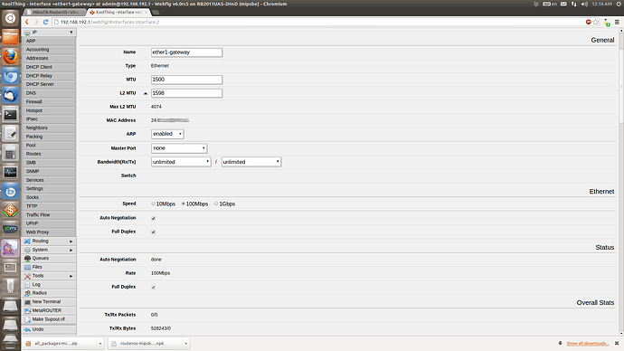

First thanks for the post, I have an XS4all fiber to the home and I like the Routerboards much more with the supplied Fritzbox 7390.
Originally I had an RB751U-2HnD, over which I tried your above config. I created only vlan 6 because I use only the internet connection without the TV (vlan 4), and I attached the vlan 6 to the gateway eth1. I then created a pppoe and associated it with the vlan 6 interface.
After hooking up the 751 to the fiber, I saw the pppoe trying to dial and disconnecting constantly. I also saw that it's useless for the pppoe to try to connect since there was no RX traffic on the gateway eth1. Therefore xs4all doesn't respond to the RB vlan 6 for some reason. I did see TX traffic on eth1, so the interface is enabled. FW rules completely open to input, output and forward (for now), mac address of eth1=mac of Fritzbox. This does not resolve over time with waiting, RX traffic from the genesix fiber box just doesn't arrive at all.
In my attempts to get the vlan to be recognized I also did some specific switch related command regarding the eth port:
interface ethernet switch vlan add switch=switch1 ports=ether1-gateway vlan-id=6
Which gives an error "this command isnt supported" in the RB751.
I decided to try an RB2011, same model as you used, configured it the same way I did the RB751 with vlan6 interface on eth1, open FW, and xs4all pppoe. The result was the same, no RX from the fiber on eth1 and constant reconnect attempts from the pppoe. I also tried separating the eth1 with dialer and vlan to a separate bridge interface from the lan, but still no RX on eth1.
In the case of the RB2011, I was allowed to use the switch vlan command which isn't invoked when creating the interface vlan, but it doesn't change the RX issue:
[admin@KoolThing] > interface ethernet switch vlan add switch=switch1 ports=ether1-gateway vlan-id=6
[admin@KoolThing] > interface ethernet switch vlan print
SWITCH VLAN-ID PORTS
0 switch1 6 ether1-gateway
The Fritz connects straight away, I have a neighbor (Ams east) with a BSD box connected to an xs4all fiber, it's just the RB that we can't get to connect using vlans.
On a KPN fiber in Ams west a friend of mine placed a managed LAN switch between the RB and the genesix which handled the vlan tagging, it solved the issue, but the RB should do vlans without an extra LAN switch.
I wonder is this a bug or a feature? :wink:
I tried with the latest stable 5.22 and the 6 RC4. Bellow are some screenshots that show the 0 RX.
If anyone else encountered and solved this, please post info.

I’ll try to clarify my setup.. I haven’t been messing around with switch configuration.
  1. connect the genexis fiber-to-ether thing to ether1 on the mikrotik.
  2. create two VLAN’s on ether1:
/interface vlan add arp=enabled disabled=no interface=ether1-gateway l2mtu=1594 mtu=1500 name=vlan4 use-service-tag=no vlan-id=4
/interface vlan add arp=enabled disabled=no interface=ether1-gateway l2mtu=1594 mtu=1500 name=vlan6 use-service-tag=no vlan-id=6
  1. create the pppoe-client, make sure the interface is vlan6 (one you just created), and change the mac-addr to your old device (eg: experiabox, fritzbox)
/interface pppoe-client add ac-name="" add-default-route=yes allow=pap,chap,mschap1,mschap2 dial-on-demand=no disabled=no interface=vlan6 max-mru=1480 max-mtu=1480 mrru=disabled name=pppoe-kpn password=kpn profile=default service-name="" use-peer-dns=no user=XX-XX-XX-XX-XX-XX@direct-adsl
  1. it can take a while for pppoe to connect properly.. let it try for 10 minutes or so.. then it should be up.

This might work fine for KPN but either does not work for Xs4all or does not work when you only have internet (without iptv). Either way, I have tested this numerous times and when you use an untagged vlan6 connection, it works within 1 minute, with a tagged connection and MT handling the vlan conversion, it simply does not work.
I still have an open support call with MT and will do some network captures to further troubleshoot what’s going on (no pppoe traffic being returned).
Btw, I did another test with a Ubiquiti edgerouter lite and this worked fine (exact same setup with the edgerouter handling the vlan conversion).
I’m trying to solve the pppoe problem to but how do you set the mac of the ether1-gateway to the mac of the modem?
this is the only differance in my setup and i can not get it to work.

I would seriously doubt this would fix your problem (but feel free to prove me wrong :slight_smile: ) As already stated, I have hooked up several other devices, did not modify any mac address at all and they all worked fine (expect for the Mikrotik).
I’m convinced this is a bug in the PPPoE implementation when using a vlan.

You could look at the bottom of this page about Jumbo frames if that will solve your problem with Xs4all fiber. The router they use for fiber are MX960 and they are supporting RFC4638.
http://wiki.aa.org.uk/index.php/RouterOS#1500_MTU_over_PPPoE_using_baby_jumbo_frames
