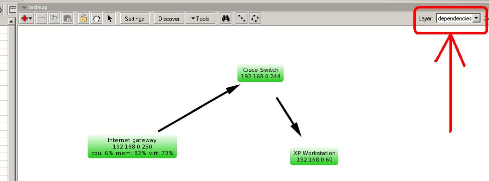

To make device depended on other devices look at sample
Asume that Dude server is somewhere in internet.
The dependance shows how the packet flows from Dude to device.
If switch will be down WinXP station will be in unknown state, if router will be down swith and workstation will be in unknown state. When device goes in unknown state it does not generate any alert.
In a such a situation you also should make router to go in down state faster then other devices. To do it you may check it ping status more frequent.

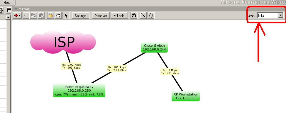

I have a link between two devices monitoring the traffic, as shown in the picture below.
I would like to know if it is possible to make The Dude notify me (preferably with e-mail), when this traffic goes over 100 Mbps.
