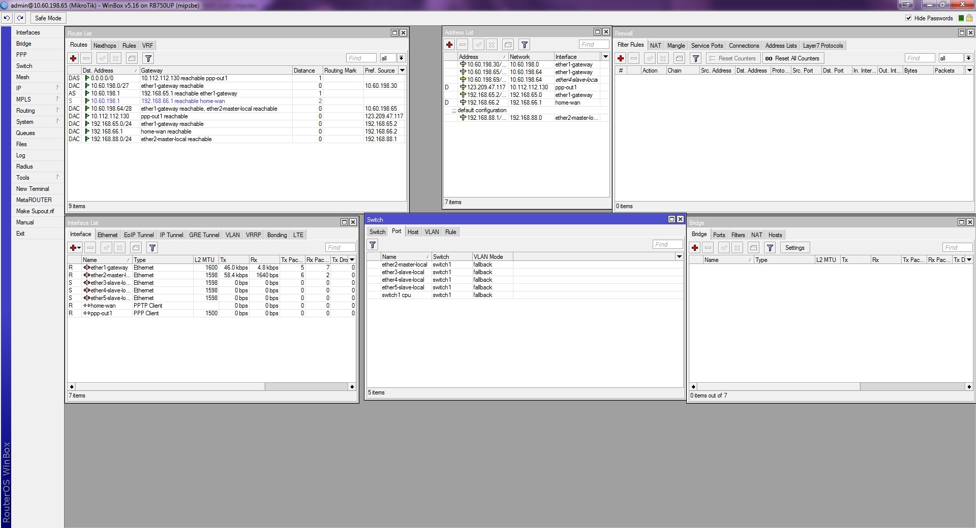

i will add a screenshot which shows some info…
i’m thinking it has something to do with the routing table there is an automatically added entry of 10.60.198.0/27 via ether1-gateway when it’s quite obvious that it’s not reachable via that port… i can delete it it just appears on it’s own! i’m pretty sure that’s my problem. how can i make all ports seperate, no mast/slave config?

the entry 10.60.198.0/27 via ether1 is fine when the cable is plugged in, but when the cable is unplugged and the mikrotik should then route through the vpn rather than ether1. It doesn’t say “unreachable” like i would have expected.
I can’t route it down the vpn as the entry via ether1 is of metric 0 and all my manual entry’s go as low as 1.
