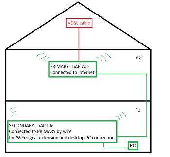

However, I also need a secondary device for WiFi signal extension and my main PC connection on the ground floor (please see my schema below).
On my old router (ZTE) I only needed to turn off the DHCP server and assign an address to it + turn on the WIFI (same ssid as primary device) and it was working fine.
But I wanted my secondary device to be as compatible as possible so instead of the old ZTE I have bought used Mikrotik hAP-lite.
I have successfully connected hAP-lite (secondary) into hAP-AC2 (primary) and the internet on my PC connected to hAP-lite (secondary) is working OK.

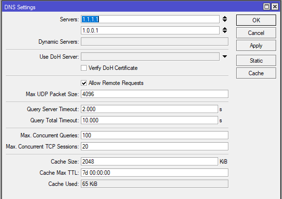

I noticed this..
set allow-remote-requests=yes servers=192.168.88.1
Which may mean you are sending dns requests from the hapaclite, to the main router but you dont allow the main router to function as DNS server from the lan. Not sure if thats how it will work as the config relationship between the two units is not clear to me.

Unfortunately, I do not understand what do you mean by “I see you dont allow DNS via the router but you do have DNS servers on the net that you have identified.”. I have DNS servers set to 1.1.1.1 and 1.0.0.1 (cloudflare) and in my PC’s ipconfig I can see the following DNS addresses 192.168.88.1, 1.1.1.1, 1.0.0.1; Also when I check hAP-AC2 DNS cache, it is full of information.
“Maybe blind but I didnt see an ip route rule?” could you please elaborate what shall I chage/set?
Should I switch allow-remote-requests=yes to allow-remote-requests=no on my hapaclite?

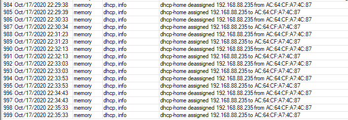

Hopefully my last question, when I check my log I see the following rows all the time.
I have found out this is my Xiaomi Vacuum Mop https://www.amazon.de/-/en/Xiaomi-25012-Robotic-Vacuum-Cleaner/dp/B0852NHYC7/ref=sr_1_5?dchild=1&keywords=xiaomi+mijia+robot+staubsauger+1c&qid=1602967092&sr=8-5
Should I care about it? Is there anything I can do?

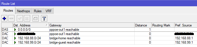

is this OK then? :slight_smile:
