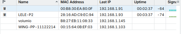

Hi , All device have 192.168.1.xxx and respond at the ping , also the phone

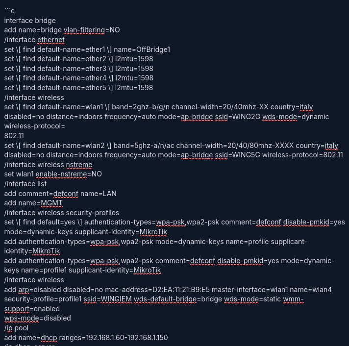

Okay so this is simply attach a device to a non-internet connected wifi router such that one can locally, use an app and access device over wifi network.
No vlans do not enable bridge vlan filtering
Simple wifi nstreme NOT enalbed
What is the purpose of multiple wifi
wlan1 = 2ghz wifi purpose =?
wlan2 = 5ghz wifi purpose =?
wlan4 = master wlan1 purpose= ?
wlan3 =master wlan2 purpose=?
No internet, all on same subnet structure so what is the purpose of a second 2ghz network? and second 5ghz network?? { you have *2 by security profile which indicates some mismatch in settings)
Single pool!
WHY all bridge ports disabled?? okay no need for connectivity,
Save to administer the router, so lets use ether2
Suggest doing so on ether1. will be an off bridge access
This will serve as an emergency access to the router in case the bridge burps and you cannot access through ether port2 on the bridge subnet. Simply plug your laptop into ether1, change ipv4 settings to 192.168.77.2 and with username and password you should be in.
What you have done with addresses assigning one to bridge and to port is too funky for me.
Keep it clean and separate.
Simplify and back to standard defaults for the most on firewall rules. Although in this case none really needed.
Remove ipv6 crap, a because Im allergic to it, and also not needed for mixer.
interface bridge
add name=bridge vlan-filtering=NO
set \[ find default-name=ether1 \] name=OffBridge1
set \[ find default-name=ether2 \] l2mtu=1598
set \[ find default-name=ether3 \] l2mtu=1598
set \[ find default-name=ether4 \] l2mtu=1598
set \[ find default-name=ether5 \] l2mtu=1598
/interface wireless
set \[ find default-name=wlan1 \] band=2ghz-b/g/n channel-width=20/40mhz-XX country=italy disabled=no distance=indoors frequency=auto mode=ap-bridge ssid=WING2G wds-mode=dynamic wireless-protocol=
802.11
set \[ find default-name=wlan2 \] band=5ghz-a/n/ac channel-width=20/40/80mhz-XXXX country=italy disabled=no distance=indoors frequency=auto mode=ap-bridge ssid=WING5G wireless-protocol=802.11
/interface wireless nstreme
set wlan1 enable-nstreme=NO
add comment=defconf name=LAN
add name=MGMT
set \[ find default=yes \] authentication-types=wpa-psk,wpa2-psk comment=defconf disable-pmkid=yes mode=dynamic-keys supplicant-identity=MikroTik
add authentication-types=wpa-psk,wpa2-psk mode=dynamic-keys name=profile supplicant-identity=MikroTik
add authentication-types=wpa-psk,wpa2-psk comment=defconf disable-pmkid=yes mode=dynamic-keys name=profile1 supplicant-identity=MikroTik
/interface wireless
add arp=disabled disabled=no mac-address=D2:EA:11:21:B9:E5 master-interface=wlan1 name=wlan4 security-profile=profile1 ssid=WINGIEM wds-default-bridge=bridge wds-mode=static wmm-support=enabled
wps-mode=disabled
add name=dhcp ranges=192.168.1.60-192.168.1.150
add address-pool=dhcp interface=bridge name=defconf
/system script
add comment=defconf dont-require-permissions=no name=dark-mode owner=\*sys policy=ftp,reboot,read,write,policy,test,password,sniff,sensitive,romon source="\\r
\\n :if (\[system leds settings get all-leds-off\] = "never") do={\\r
\\n /system leds settings set all-leds-off=immediate \\r
\\n } else={\\r
\\n /system leds settings set all-leds-off=never \\r
\\n }\\r
\\n "
/interface wireless
add disabled=no mac-address=D2:EA:11:21:B9:E6 master-interface=wlan2 name=wlan3 security-profile=\*2 ssid=WINGIEM
/disk settings
set auto-media-interface=bridge auto-media-sharing=yes auto-smb-sharing=yes
add bridge=bridge disabled=NO interface=ether2 comment="admin access via bridge"
add bridge=bridge disabled=yes interface=ether3
add bridge=bridge disabled=yes interface=ether4
add bridge=bridge disabled=yes interface=ether5
add bridge=bridge disabled=NO interface=wlan1
add bridge=bridge disabled=NO interface=wlan2
add bridge=bridge disabled=NO interface=wlan3
add bridge=bridge disabled=NO interface=wlan4
set discover-interface-list=MGMT
add defconf interface=bridge list=LAN
add interface=OffBridge1 list=LAN
add interface=bridge list=MGMT
add interface=OffBridge1 list=MGMT
/interface wireless sniffer
set multiple-channels=yes
add address=192.168.1.1/24 comment=defconf interface=bridge network=192.168.1.0
add address=192.168.77.1/30 interface=ether1 network=192.168.77.0
/ip dhcp-client
add comment=defconf disabled=yes interface=ether1 name=ether1
add address=192.168.1.0/24 comment=defconf dns-none=yes gateway=192.168.1.1
set allow-remote-requests=no
add action=accept chain=input connection-state=established,related,untracked
add action=drop chain=input connection-state=invalid
add action=accept chain=input comment="defconf: accept to local loopback (for CAPsMAN)" dst-address=127.0.0.1
add action=accept chain=input comment="admin access" in-interface-list=MGMT
add action=drop chain=input comment="drop all else"
add action=fasttrack-connection chain=forward connection-state=established,related
add action=accept chain=forward connection-state=established,related,untracked
add action=accept chain=forward comment="admin access" in-interface-list=MGMT \
out-interface-list=LAN
add action=drop chain=forward comment="drop all else"
{ Note traffic between devices on same subnet is at level 2, not level 3 }
add action=masquerade chain=srcnat comment="defconf: masquerade" ipsec-policy=out,none out-interface-list=WAN disabled=yes
/ip firewall service-port
set irc disabled=no
set rtsp disabled=no
/ipv6 services disabled
/system clock
set time-zone-name=Europe/Rome
/system routerboard mode-button
set enabled=yes on-event=dark-mode
/tool mac-server
/tool mac-server mac-winbox
set allowed-interface-list=MGMT
/tool traffic-monitor
add interface=wlan4 name=tmon1 traffic=received
put all this into a code block
interface bridge
/interface wireless
802.11
add name=MGMT
/interface wireless
wps-mode=disabled
/system script
\\n } else={\\r
\\n }\\r
\\n "
/interface wireless
/disk settings
/ip dhcp-client
set irc disabled=no
/system clock
/tool mac-server
u end it the same way u start it
works for you ever since MT change the website, I can never get an output the way I like it, or for it to show up clean so I have given up trying
try again or you'll never know.
maybe with green eggs and ham, I may like it!!
[admin@hAP] > ping 192.168.1.145
SEQ HOST SIZE TTL TIME STATUS
0 192.168.1.145 56 64 808us
1 192.168.1.145 56 64 765us
2 192.168.1.145 56 64 796us
3 192.168.1.145 56 64 731us
4 192.168.1.145 56 64 780us
5 192.168.1.145 56 64 789us
6 192.168.1.145 56 64 786us
7 192.168.1.145 56 64 774us
8 192.168.1.145 56 64 803us
9 192.168.1.145 56 64 846us
sent=10 received=10 packet-loss=0% min-rtt=731us avg-rtt=787us
max-rtt=846us
[admin@hAP] > ping 192.168.1.103
0 192.168.1.103 56 128 583us
1 192.168.1.103 56 128 465us
2 192.168.1.103 56 128 484us
3 192.168.1.103 56 128 364us
4 192.168.1.103 56 128 546us
5 192.168.1.103 56 128 496us
6 192.168.1.103 56 128 518us
7 192.168.1.103 56 128 479us
8 192.168.1.103 56 128 463us
sent=9 received=9 packet-loss=0% min-rtt=364us avg-rtt=488us max-rtt=583us
[admin@hAP] > ping 192.168.1.91
0 192.168.1.91 56 64 319ms221us
1 192.168.1.91 56 64 240ms563us
2 192.168.1.91 56 64 169ms375us
3 192.168.1.91 56 64 284ms145us
4 192.168.1.91 56 64 115ms214us
5 192.168.1.91 56 64 130ms613us
6 192.168.1.91 56 64 58ms29us
sent=7 received=7 packet-loss=0% min-rtt=58ms29us avg-rtt=188ms165us
max-rtt=319ms221us
if I connect the phone in wireless router TPLINK ac80 AND connect THE AC80 lan on mikrotik router lan the app WING-Q work corretly
103 is mixer wing
145 is player music volumio
93 is my pc
91 is the phone
all ping work correctly
for each address
Drotz : same condition don't work
