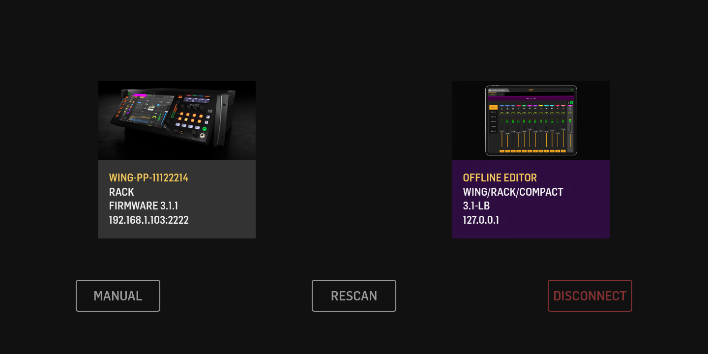

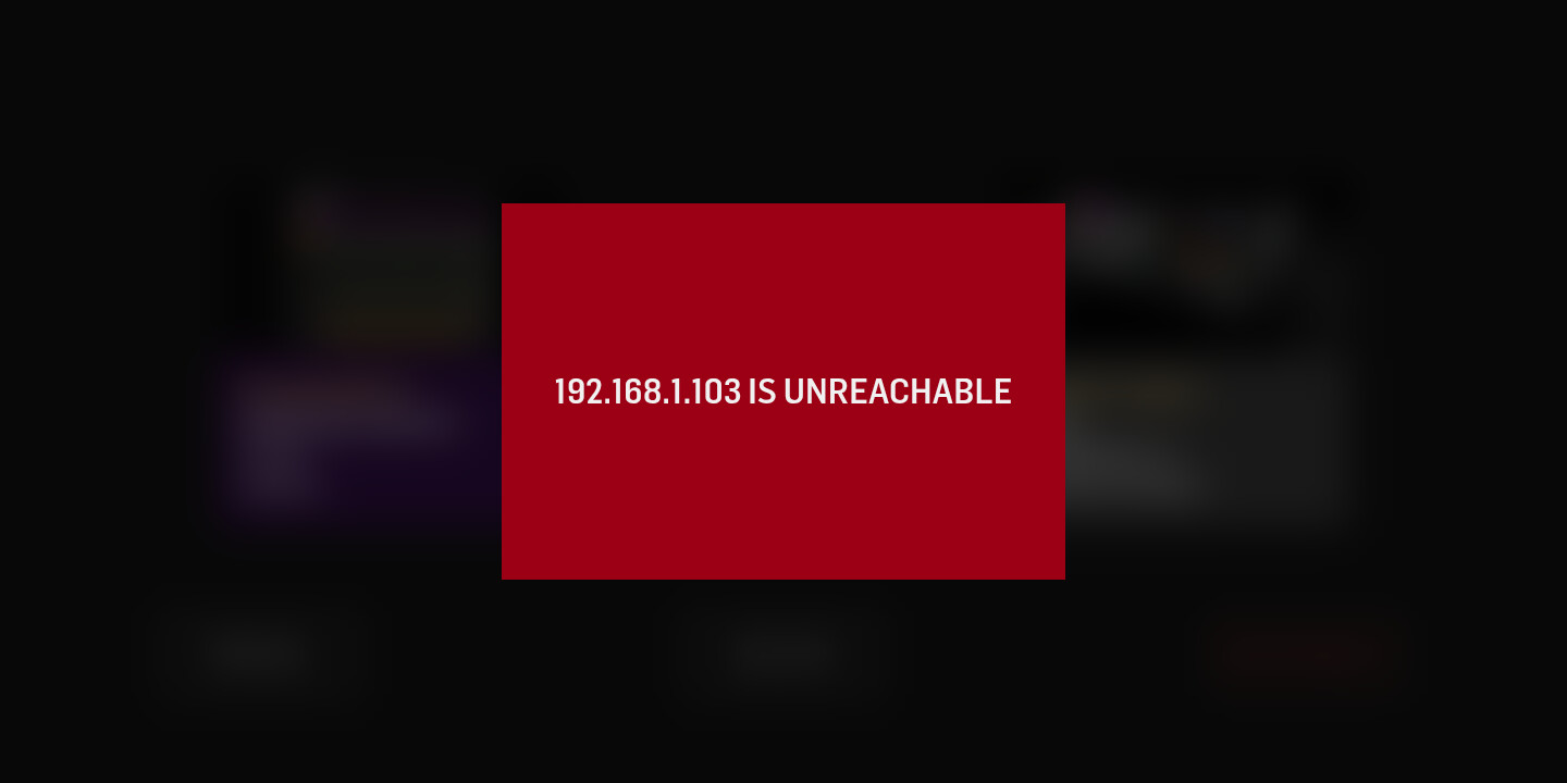

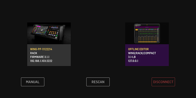

Behringer win and hap ax3

Hi AMM0 , i follow your istructions , bat the situation is immutate :frowning:
So at this point what's working and what's not working?
Perhaps do another /export terse file=config.rsc, and then use Files to download/cut-and-paste it here.

While running various tests, I connected my mobile phone to wifi1 (I usually connect it to wifi4), while keeping the PC on wifi1.
if I make several connection attempts using WING-Q and then WinBox on the PC, the connection WINBOX drops and I have to reconnect the pc , maybe the wifi1 crash ?.

Last night GIG using the WING and "hAP ac³ . Distance from the stage was 30 meters, with no disconnections, no interference, or slowdowns;
this was with a crowd of 1,500 people, meaning 1,500 mobile phones in the area between the wing and the mixer.
Excellent!
