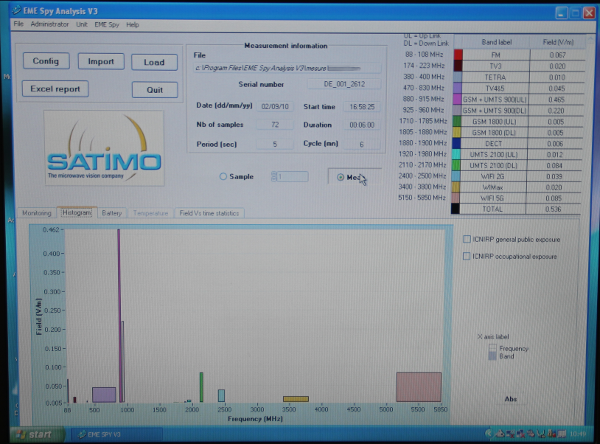

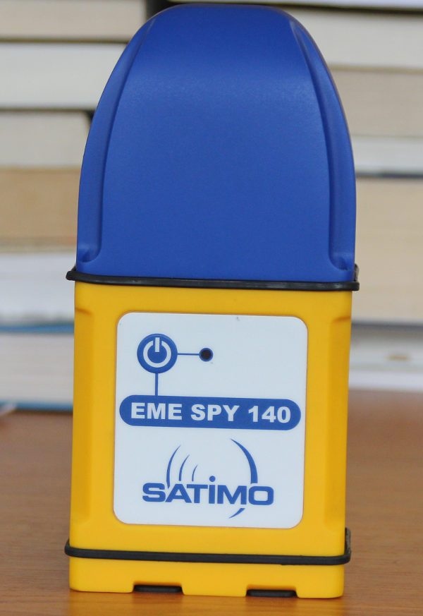

I have experienced a measurement for a school.
The measurements take place with an appliance will be shown here.
They calculated the number of volts per meter.If a violation is measured.
The BIPT come with more advanced devices.

What you see here is a measurement carried out by the Ministry of health.
When in doubt become more sophisticated material used.
The BIPT is measuring.
I have never experienced a more comprehensive measurement.
