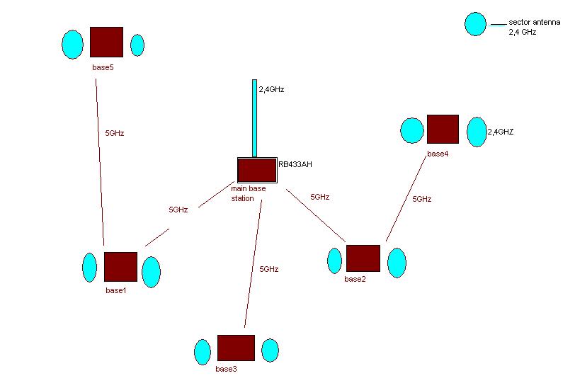

Hi once again. I have 6 mikrotiks bridged together with 5GHz cards, and every base station has 2 sector antennas , the router is IPACCT . So can someone tell me how to configure it for best performance.
Would like some more info. Guessing the mikrotik you talk about and the base station is the same thing and you want to put data in on one side and take it out on the other with six mikrotik linking to each other? If this is correct set one side as WDS client and the other side as Access point with dynamic WDS enabled on all six.
yes all six mikrotiks is base station, every base stations has 2 sector antennas they are AP-WDS, they are in distance of 1,5-2 km, they’re working for now but i don’t think it’s good, ping from client to the main base station is 20-30 ms, signal of client is ok, above 40 dB.
Sheme is in picture above .
