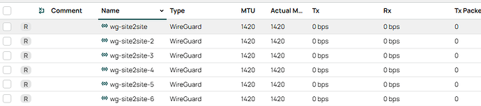

I’m currently using Wireguard and i have 6 seperate tunnels setup and then added routes for each tunnel and IP address
increasing the tunnels to 6 has increased the line speed to around 3.5gbps
