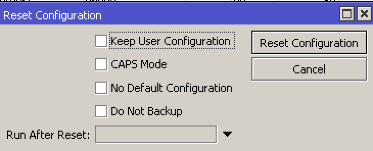

Thanks, what option?
Cheers
Peter
Reset configuration

Reset configuration
Did I not select any box?

hi, It depends, I always do it with “no default config” so that the router is really clean and you can start over. cheers

Try only the box, no backup! and then select the reset configuration button.
Otherwise what I recommended above this option.,
