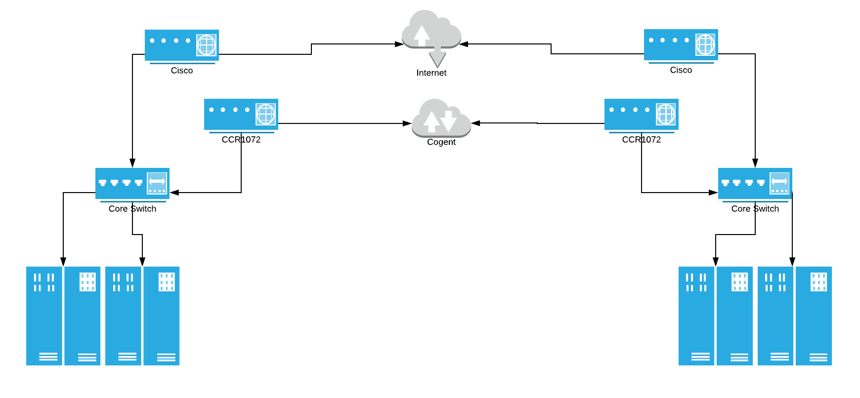

I put a small network diagram to try to be more explained:
On the contrary I have to comment that it goes over the Cogent network, so the MTU is 1500 and there is no MPLS on his network to try to use.
