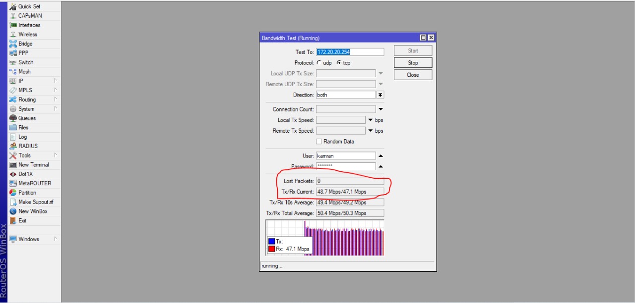

I have ptp link on LHG5 (distance 600 meter). When I use bandwidth test it shows only 47 to 50mbps tx/rx. Even MikroTik say 300 Mbits on their website (product description).
facing same issue on SXTsq Lite 5 ptp link (distance 300 meter)

Please look at this images

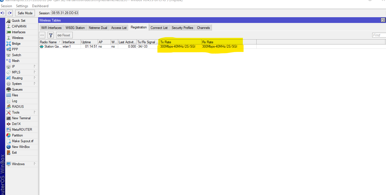

-34 / -33 ?? too high,
see both cpu used when you do bandwidth test…

These pictures show that the points are connecting at a maximum possible channel rate of 300 mbps. Which is about 200 mbps of usable bandwidth, but since the link is half-duplex it would be about 100 mbps in full duplex.
The following picture shows the maximum speed the processor can generate. Run TCP transmit or receive only and the processor will be able to generate up to 80-100 mbps of traffic, run UDP transmit or receive only and the processor will be able to generate around 180-200 mbps of traffic. It was explained to you that you do not see the bandwidth of the wifi channel, but the speed that the processor can generate.
PS To improve the performance of the wifi bridge you need to reduce the power on both sides by about 15 -18 dBm. So that the signal level is not -34/-33dB, but -50/-50dB. Because of the very strong signal you have a low CCQ.
