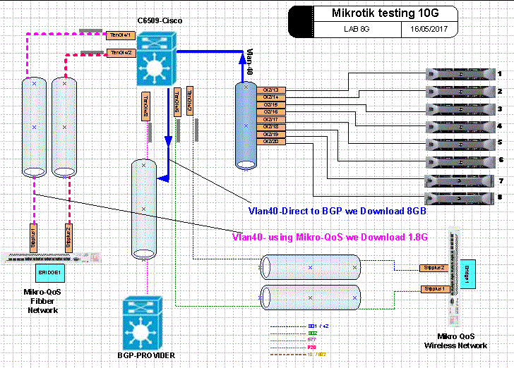

Mikrotik Engineer.- We are testing Mikrotik CCR1072 and CCR1036 with SFP-10G with objetive to be use how QoS or Firewall on the last version of Mikrotik.- I attach the picture and I expect that you understand more clear.
Situation:

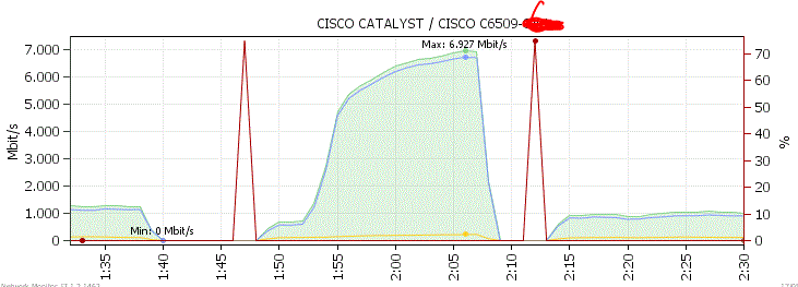

If I connect 8 Server using a Vlan40 where I set to each server and Public IP Address with mask /28 I set the first Ip to the Vlan40.- I testing download without pass over the Mikrotik QoS/Fibber I Get 8GB on the probe.- If I setup that the traffic that come from my BGp provider that download from the Mikrotik QoS-Fiber and I make the test using my 8 Server just i get 1.8G of traffic.

  1. Do you consider that I need to put Fibber cable that come from my BGP provider direct to the Mikrotik-QoS-Fiber and After from the Mikrotik to the Cisco, on this way you consider that I can get 8G If I make the test with the Server?
  2. Do you consider that Mikrotik CCR1072+10G-SFP On bridge SFP1/SPF2 dont pass more than 1.8G of traffic?

This morning, we pass the traffic direct without the Mikrotik QoS - Fibber, after we make a download using 8 Debian Server, and the result was more than 7GB aprox.- on This case if you note Mikrotik using Bridge of the SFP+ just to permit pass 1.8G.- The main point here is how do you can pass over the Mikrotik on this LAB 10G without any firewall rule or any Mangle.

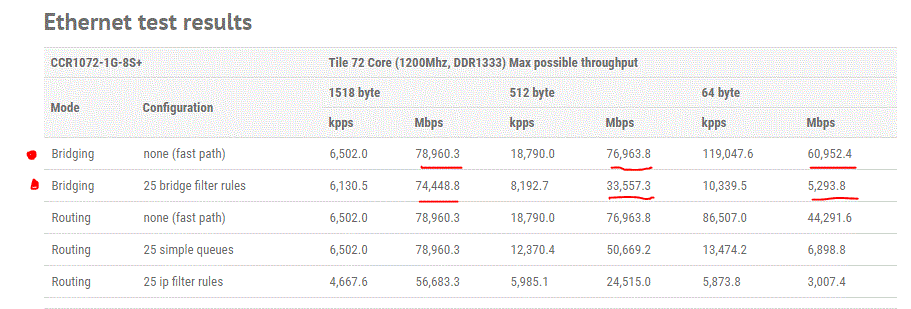

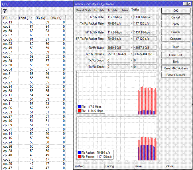

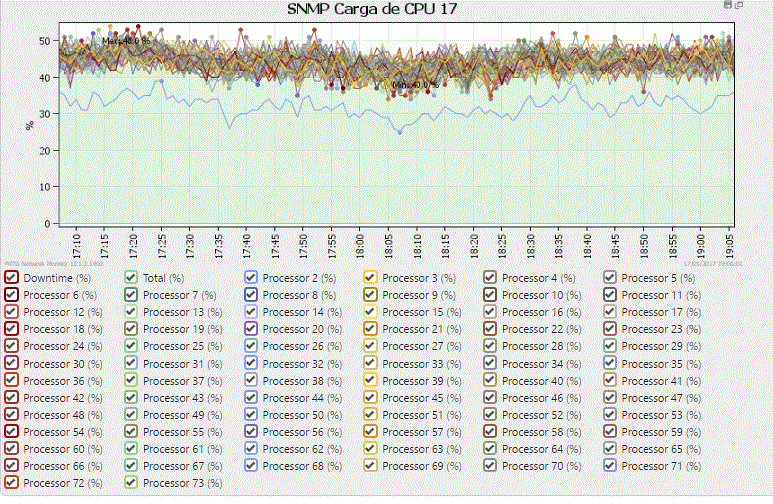

I see on the https://routerboard.com/CCR1072-1G-8Splus, the Ethernet test result, where on bridge none (fast path) mode aparently permit to be pass 1518(78,960.3), 512(76,963.:sunglasses:, 64(60,952.4) but on this case I can reach that result on the real traffic.
