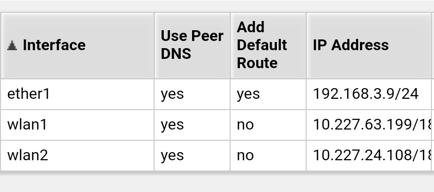

As I can see, you have another dhcp client attached to ether1, with add-default-route=yes, so you have to adjust the suggestion above to your setup as a whole.

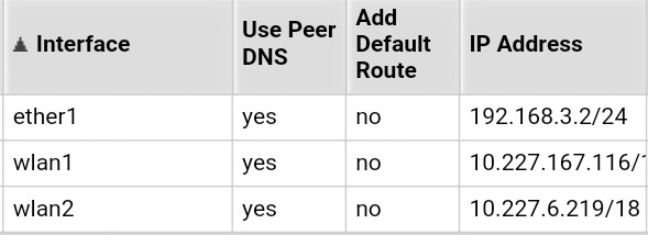

  • ether1 50M DL 50M UL
  • wlan1 50M DL 50M UL
  • wlan2 20M DL 4M UL
I adjusted like this

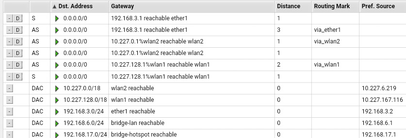

What I can see is that you use underscore (via**_wan1) in the routing-mark values set on the routes, but in the mangle rules, you assign values with a dash (via-**wan1).
It means that all the routing-mark values assigned by mangle are unknown to the routing, so it falls back to routing table main (consisting of routes with no routing-mark value assigned).

First, have you fixed the mismatch between routing-mark values used in routes and mangle rules, and does load distribution work now?

Yes, I fixed it. But sometimes it likes to lose connection and unstable speed.
That’s too vague a description, so I’d exclude one of the WANs at a time and see whether the other one is not unstable on its own.
Regarding “what’s the best”, I gave my opinion in the topic which @anav has referred above. None of the approaches can affect connection losses and jumping speed, it must be something else.
