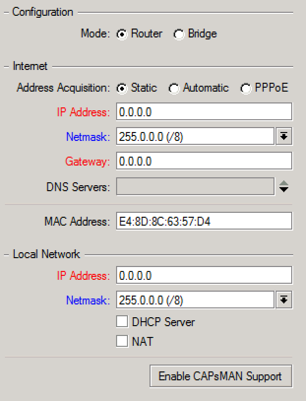

Ok great, I will keep one DHCP server, this was my logical as well. I need to resolve getting the IP address from the central DCHP server. This is my major problem at the moment. I also have a situation that the IP address on the ether1 as well as on the WLAN is set to 0.0.0.0. This is really strange and seems to be incorrect to me. See screenshot.
Quickset is not good way to make settings. Better to reset the device with no defaults and set it manually from blank.
It will be bridging, so it doesn’t need any ip address at all. But you can add management ip for better accessibility, snmp and whatever else reason.
Looks like my problem is solved. The HP port on which the Mikrotik was connected was set in Trunc mode (if I’m correct), in other words it was not configured correctly and that is why the Mikrotik didn’t got an IP address from my management network. It is all sorted out now and it is working perfectly and stable.
