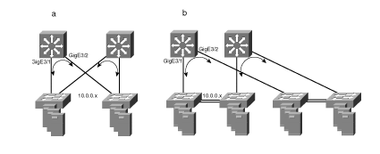

I would like to setup a redundant arch lookings like the case B there but using 2 CCR2004 for the L3 level for now:
What would be the most efficient way to build a bridge and pass some vlans between them. Also which bandwidth/latency could I expect from it?

right. I’m trying to connect converged proxmox servers . I agree the CCR2004 may not be the right solutions there but unsure if it’s feasible with the mikrotik stack. any idea?
