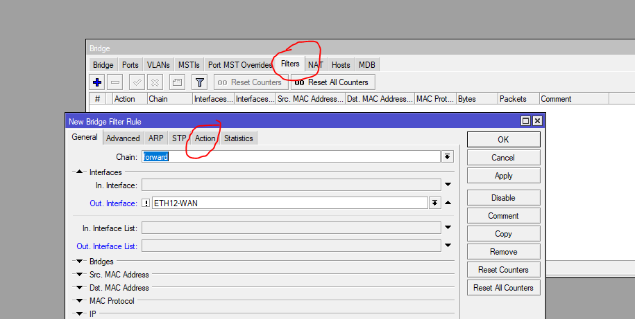

what about using filters at bridge level? Antything what is forwarded to other interface than WAN should be dropped.
