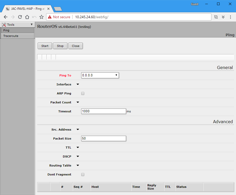

I have seen similar request a while ago and my suggestion is to give user test+read+web permissions and assign him special webfig layout which will allow him to do only a ping (and traceroute or other tests):
/user group
add name=testgroup policy="read,test,web,!local,!telnet,!ssh,!ftp,!reboot,!write,\
    !policy,!winbox,!password,!sniff,!sensitive,!api,!romon,!dude,!tikapp" \
    skin=testskin
/user
add group=testgroup name=test

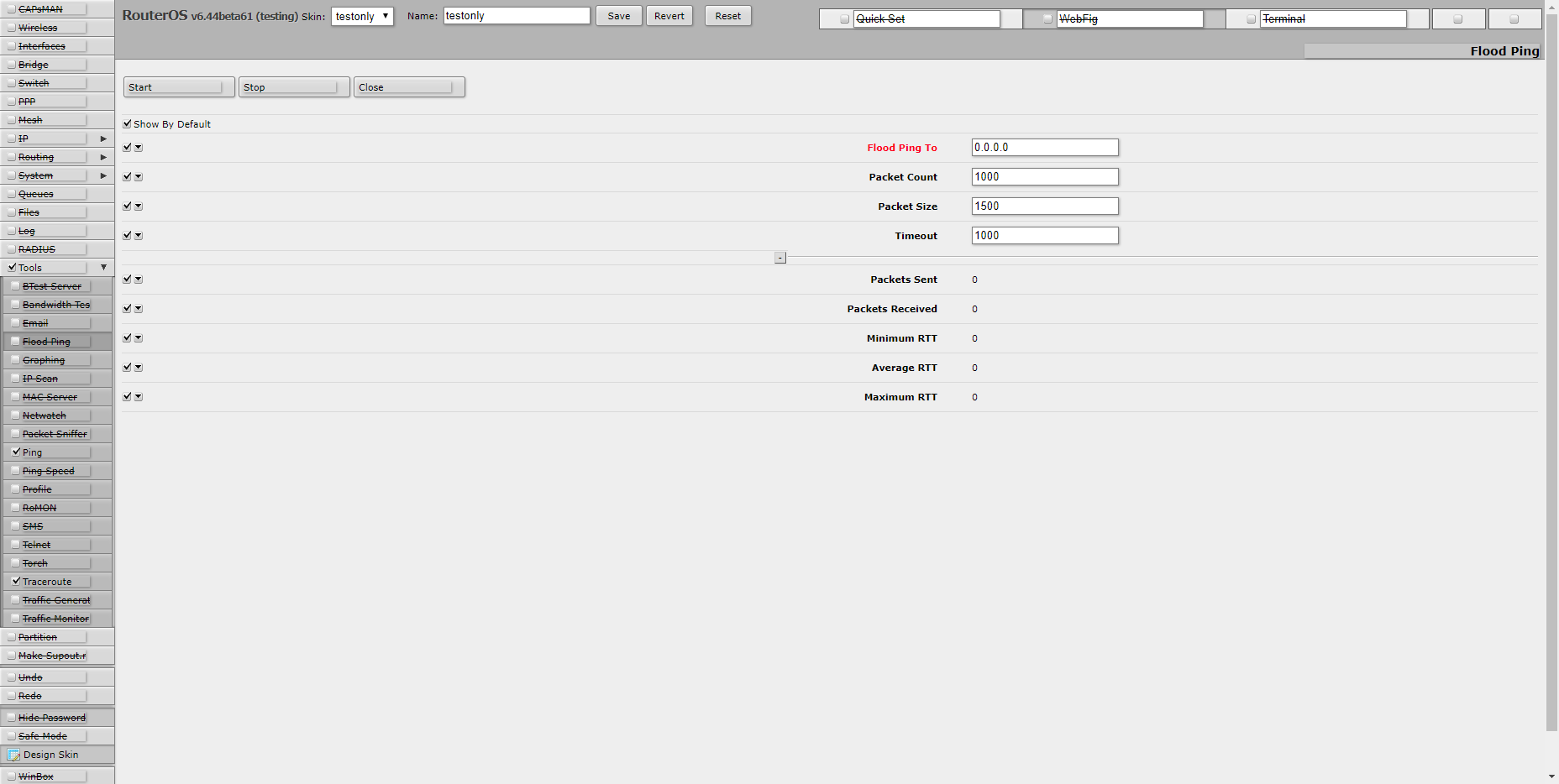

file testskin.json (source code for the skin, should be placed in /flash/skins directory)
    'Quick Set': 0,
    WebFig: 0,
    Terminal: 0,
    Manual: 0,
    Logout: 0,
    CAPsMAN: 0,
    Wireless: 0,
    Interfaces: 0,
    Bridge: 0,
    Switch: 0,
    PPP: 0,
    Mesh: 0,
    IP: 0,
    Routing: 0,
    System: 0,
    Queues: 0,
    Files: 0,
    Log: 0,
    RADIUS: 0,
    Tools: {
        'BTest Server': 0,
        'Bandwidth Test': 0,
        Email: 0,
        'Flood Ping': 0,
        Graphing: 0,
        'IP Scan': 0,
        'MAC Server': 0,
        Netwatch: 0,
        'Packet Sniffer': 0,
        'Ping Speed': 0,
        Profile: 0,
        RoMON: 0,
        SMS: 0,
        Telnet: 0,
        Torch: 0,
        'Traffic Generator': 0,
        'Traffic Monitor': 0
    Partition: 0,
    'Make Supout.rif': 0,
    Undo: 0,
    Redo: 0,
    'Hide Passwords': 0,
    'Safe Mode': 0,
    WinBox: 0,
    Graphs: 0,
    License: 0
If you are not sure how to upload the skin, you can create it manually:
and the result will look like this:
Not a best solution but maybe good enough?
