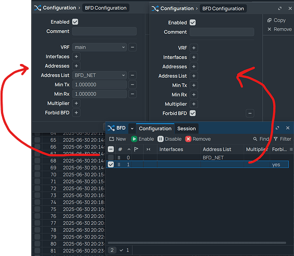

Do you have BFD configuration for 7.x enabled properly?
I did the same mistake. No BFD traffic allowed at 7.x side.

Configuration entries are order sensitive
Having a look at BFD - RouterOS - MikroTik Documentation
looks like addressing is used for multihop which i’m not using - can I not just leave it blank
Hmmm that seems to imply i need to add ip address - that I didn’t know I used a v6 to v7 upgrade - I will go read the doco
