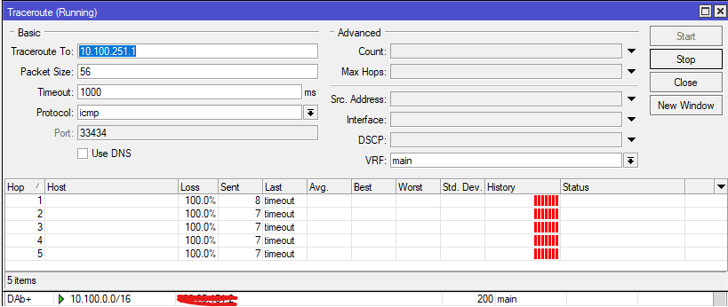

DAb 10.0.0.0/8 x.x.x.x 200
x.x.x.x being public IP of peer. next hop choice set to force self on both sides
But cannot route to the 10 range
When I use tunnel iBGP this traceroute is successful.
did the remote 10/8 have a correct route to your src subnet?
both are learning the correct public IP as the gateway on each respective side.

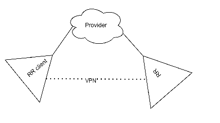

In my diagram.... I basically want to create a RouteReflector and a RouteReflector Client. routes populate but don't send traffic.
I am creating iBGP via Public IPs that aren't directly connected hence the Multihop setting.
As in the diagram it works via normal iBGP via Tunnel. I don't have any eBGP peering with my up stream provider.
