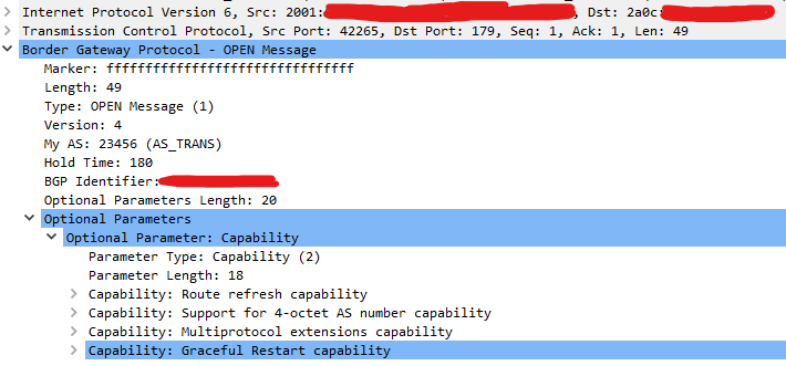

So I have been looking further into this, the edit above is inaccurate, the extra routes were not the duplicate routes I was trying to advertise, but instead my CYMRU blackholes were being sent to the service. Thankfully the information is not being used for routing packets, just informational.
After filtering out CYMRU routes, I am back to where I started. add-path-out seems to do nothing.
In fact, it does not even get added as a capability.

bgp multipath / add-path is not implemented.
So Mikrotik added an option, that does absolutely nothing…
Not even a little warning in the logs when I use it?
Warning: add-path-out is not implemented?
Or, even not showing it on prod builds?
