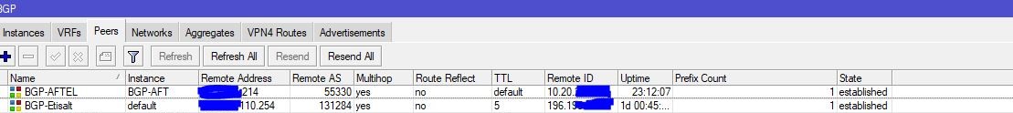

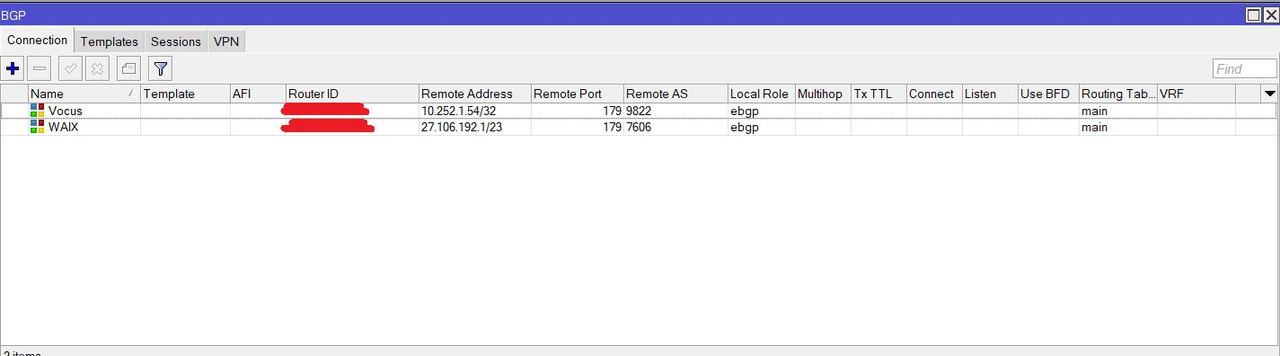

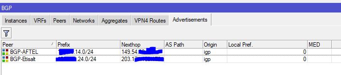

I have attached the photo config, I hope finally by looking at them you may concieve everthing. the second advertised prefix does not give reply from internet.

Okay so you have a prefix count to each so now test they are accepting it fully on the second ISP
I don’t know why you are ibgp that is just weird but they no doubt told you to do that.
Generally iBGP is when same AS to same AS number eBGP is for different AS
You clearly have different AS numbers so it should be eBGP but that is on the ISP so moving forward

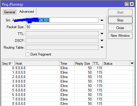

I think you have worked this out but I will walk thru it
So we need to test an IP from the prefix range on the router so put a prefix IP on any bridge or interface is fine.
*** Warning if that is a public ip you need to make sure router is protected or retards will try and log in
So lets say the isp gateway is www.xxx.yyy.zzz and your prefix ip is aaa.bbb.ccc.ddd
Now what you do is open a new terminal and ping the isp gateway from the prefix source ip
ping www.xxx.yy.zzz src-address=aaa.bbb.ccc.ddd
If it responds they are accepting your advertizing fully and you can prove that by turning off bgp and it should stop pinging.
The reason is stops pinging is they will no longer know where aaa.bbb.ccc.ddd is without the BGP … it’s pretty much instant.
Now you do the test to 1.1.1.1 or 8.8.8.8 from your prefix IP
ping 1.1.1.1 src-address=aaa.bbb.ccc.ddd
If that doesn’t work you need to talk to ISP because they have forgotten to put your prefix in there upstream filters.
Basically you can ping any router in the ISP network but can go no further.
