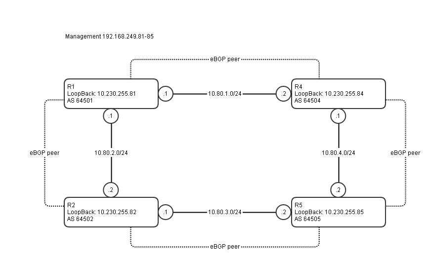

I assembled a simple stand (tested on different versions of 6.x)
A ring of 4 routers connected in series between neighbors.(see attach eBGP_test1-4.png )
BGP was raised on routers and the 1 loopback (10.230.255.x) address was announced

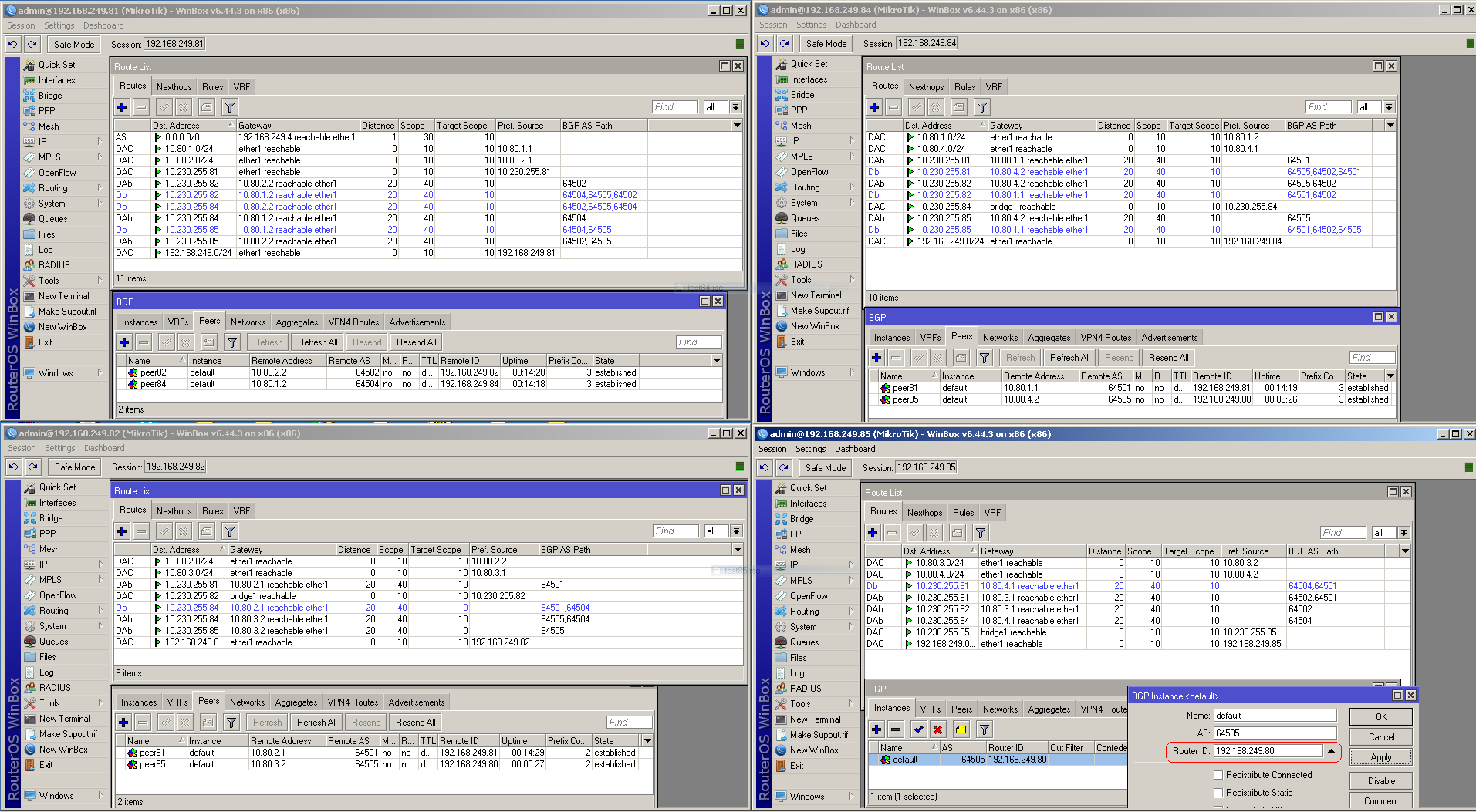

On different routers of this network there is a different number of inactive (blue routes).
I thought that bgp will choose only the best and will not add the rest.
Or If adds all possible paths to the table. then all routers should have the same number of routes.
(see attach Routes01.PNG )

the only thing i found out
the smallest ID router has the fewest blue routes.
(see attach Routes2-RouterID.PNG )

There can be only one best BGP route.
Do I understand you correctly that there should not be blue routes from BGP?
I attached the configurations of the routers, did I make a mistake somewhere when setting up the BGP?
“Blue” route is not the best route there can be a lot of inactive routes but only one best (Active) to the destination.
Why is the number of blue routes on routers different?

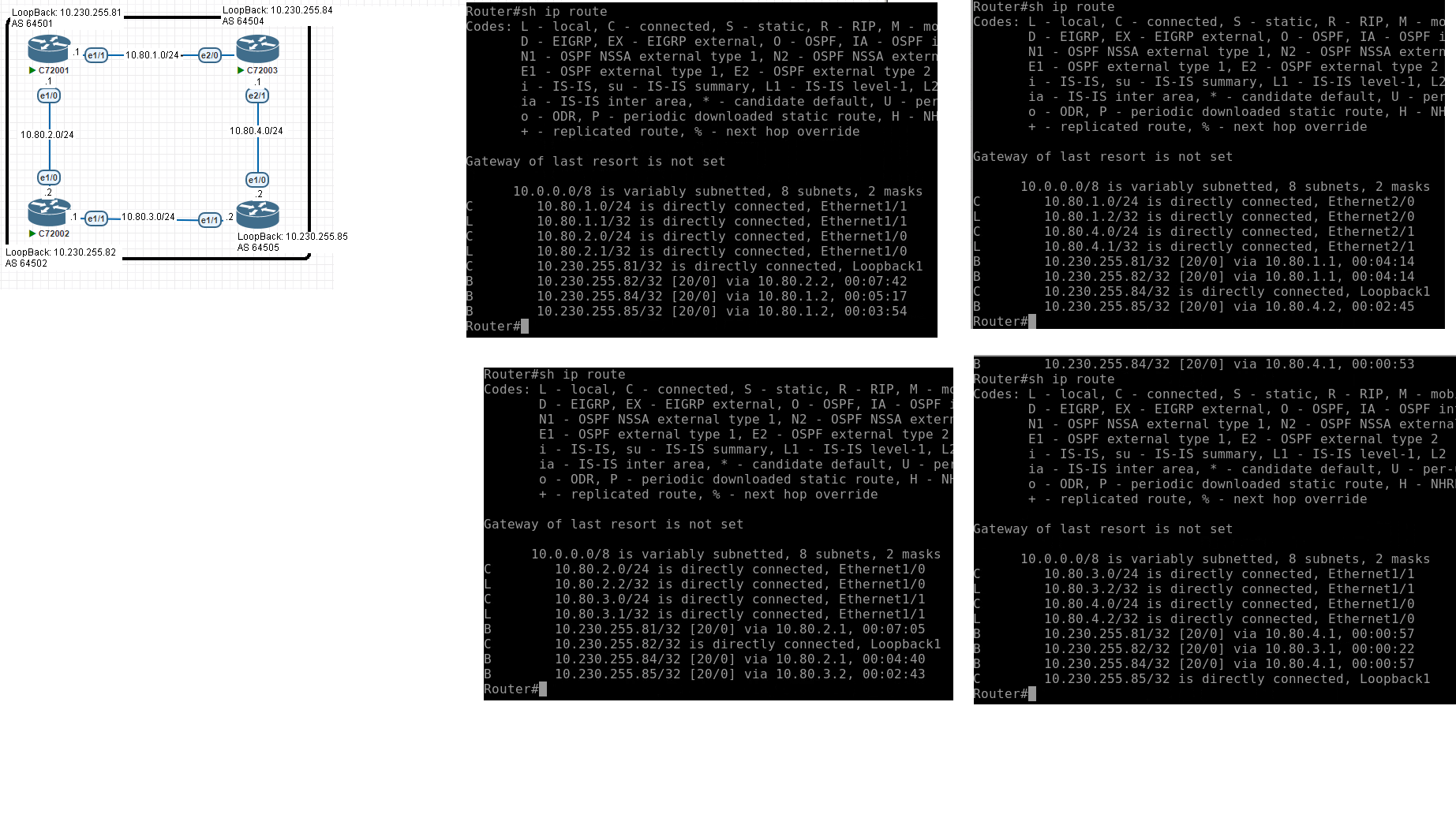

I repeated the scheme on cisco in the simulator
10.0.0.0/8 is variably subnetted, 8 subnets, 2 masks
C 10.80.1.0/24 is directly connected, Ethernet1/1
L 10.80.1.1/32 is directly connected, Ethernet1/1
C 10.80.2.0/24 is directly connected, Ethernet1/0
L 10.80.2.1/32 is directly connected, Ethernet1/0
C 10.230.255.81/32 is directly connected, Loopback1
B 10.230.255.82/32 [20/0] via 10.80.2.2, 00:07:42
B 10.230.255.84/32 [20/0] via 10.80.1.2, 00:05:17
B 10.230.255.85/32 [20/0] via 10.80.1.2, 00:03:54
There are no extra routes.
