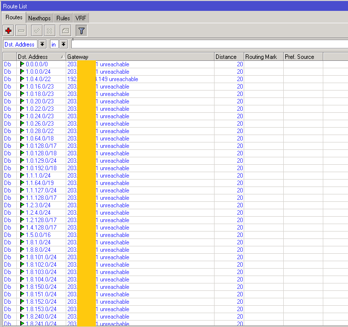

Turning on multihop does make this error go away, and the full table is accepted, however this means that while all the routes (420k of the intl table) are installed into the local routing table, by default they are all unreachable as there is no route to the various nexthops without manually adding a default route or individual static routes, (messy).
I have two other Juniper’s in the federation and I have not had to enable multihop or anything special on either of them, I also swapped the Mikrotik out for a Quagga instance on Debian 6, and it worked fine out of the box with the other Junipers in the federation.
I this a bug with Mikrotik’s implementation of BGP Federations?

It is not a bug. If peers remote address is not directly reachable then multihop must be enabled. probably juniper or quagga enables it by default.
Routes are inactive because nexthop can’t be resolved directly you need to change nexthop in routing filters or, set up recursive lookup, see example in this article
http://wiki.mikrotik.com/wiki/Using_scope_and_target-scope_attributes
