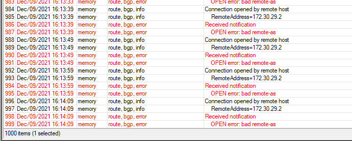

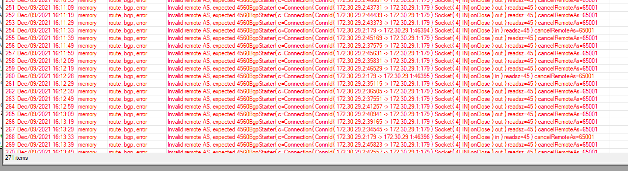

Could someone give some guidance regarding the configuration of BGP Confederation, in the new version of routerOs?
I took a CCR and updated it to version 7, but it remade the settings but when viewing via winbox, it changed something that made the session establish.
It seems to be an issue with the local.role option.
I even looked at the draft, but found it a little confused.
Could someone pass on any tips?
The settings made are:
/routing bgp connection
    add address-families=ip as=4560/65000 connect=yes disabled=no input.filter=ULTRA_CCR1072_IN \
     listen=yes local.role=ibgp name=ULTRA_CCR1072 \
     nexthop-choice=force-self output.filter-chain=ULTRA_CCR1072_OUT \
    .network=bgp-networks remote.address=172.30.29.1/32 .as=4560/65001 routing-table=main \
    templates=default
Here are some images with the error messages in the log.
Thank you in advance for your attention
Best Regards
João Pedro
