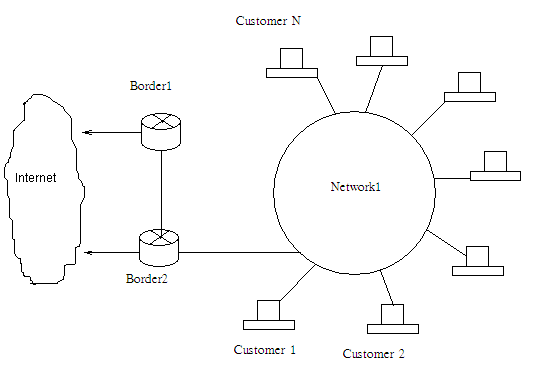

let us assume simple scheme with two routers, attached to a different isp and one lan with customers.
what we need to do to configuration at all.
exact config - at attached file.

my idea is to organize and implement that model with mikrotik routers only. futhermore, network with mikrotik routers only. :sunglasses: we plan to create small (500 customers there), span new network organization with: two border model introduced above; 100% pure mikrotik network - all routers MT boxes, no ciscos, no linuzes etc.

both routers have attached customers, not just one /as shown at the pic/.
1st MT box is attached @ isp1, 2nd - @ isp2. both routers have attached customers on it.
