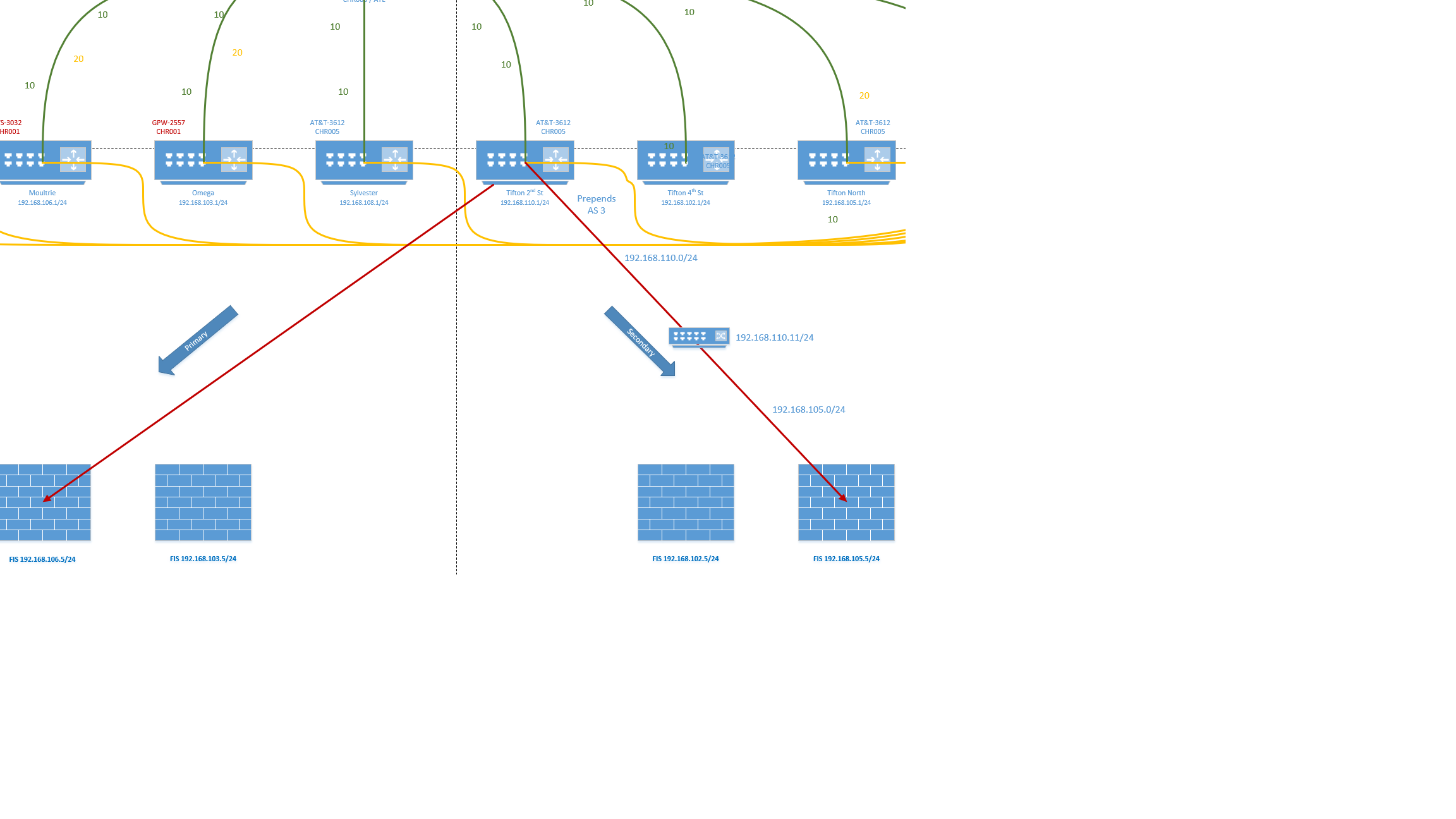

diagram attached and thinking about using as prepending. And just to clarify, I am the ISP Engineer on top of diagram and bottom is CE.
Ah okay, that helps also. I usually assume people asking are the downstream customers.
So looking at the diagram … you are sharing RFC 1918 space with a downstream customer? They’re not announcing you any public address space they’re just supposed to be announcing the 106 and 103 LANs from the left side and the 102 and the 105 LANs from the right side?
Is the customer network contiguous? The diagram seems to imply that they are fully reliant on your network to get between their sites. If that’s the case then they’re not so much multihomed.

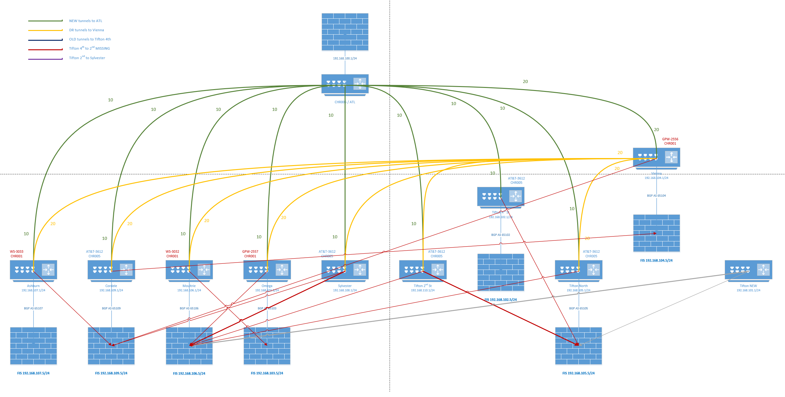

  1. What do the red lines represent?
  2. Are each of the 7 firewall icons a different customer or different sites for the same customer?
  3. Where do the public addresses come into play? Are they PI or PA addresses? Are you already announcing them to the rest of the world via BGP?

  1. Link to CE Cisco Router
  2. Yes, Branch CE Cisco Router for same customer
  3. most customer public IP Networks and I assume that they use it for internet access.

I attached the full diagram.
And are the blue and grey lines also physical links? This would mean CE router #3 from the left would have … 6 uplinks? If just counting red that would be 4?
Oh so is this concern more about their intersite connectivity than their connectivity to the internet? If their AS path for their “internal” routes is going to be 65106,65000,65105 on your diagram (this would be Moultrie to Tifton North I think), then the best path would be Tifton 2nd St because it doesn’t have to traverse the path to Vienna. (Also I’m making up that your ISP AS here is 65000; I don’t think you specified.)
This is going to involve a lot of manual policy work on your part because BGP is going to inherently hide all of the topology details of your network. What you could do is to set up a series of BGP communities that correspond to the ingress router, so say 65000:1 is routes learned from peers on Tifton 2nd St, 65000:2 is learned from peers on Tifton 4th St, etc. You can then build a routing policy for each of your routers that will announce the lowest MED for routes that originated on that router and then a higher MED for any other routes.
The customer would then receive from each upstream peer: 1) a default route (for internet traffic) and 2) all of their own routes from other sites with two possible MEDs. In the token example, as long as Moultrie still has a link up to Tifton 2nd St, they will see and use the lowest MED down that path to Tifton North. If that whole path fails then they will still have a route to it via any of their other uplinks.
