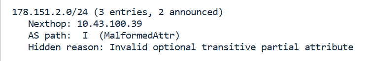

the same issue with bgp
but in my case i think problem with as-path attribute in confederation
