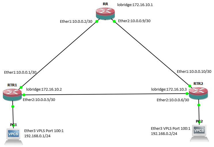

Below is a simple setup I quickly threw together in GNS3 to allow anyone to replicate the issue and to have eyes on this to see if there is some changes that can be made to get this working. Right now on v7.16 and up the VPLS tunnels no longer appear on the peers since the ibgp-rr-client was removed. If you go to a version below 7.16 you will see the VPLS tunnels do appear however their VPLS tunnel IP is the route reflect instead of the other peers that are participating in that configured VPLS tunnel. If you convert the route reflector to v6 and the peers below 7.16 everything works correctly. It seems like every updated coming out the BGP L2VPN VPLS gets broken more.
Router Reflector
[admin@RR] > export
# 2024-10-14 19:51:13 by RouterOS 7.16.1
# software id =
add name=lobridge
/routing ospf instance
add disabled=no name=ospf-instance-1 redistribute=connected,static router-id=\
    172.16.10.1
/routing ospf area
add disabled=no instance=ospf-instance-1 name=ospf-area-1
add address=172.16.10.1 interface=lobridge network=172.16.10.1
add address=10.0.0.2/30 interface=ether1 network=10.0.0.0
add address=10.0.0.9/30 interface=ether2 network=10.0.0.8
/routing bgp connection
add address-families=l2vpn as=65530 cluster-id=172.16.0.1 connect=no disabled=\
    no input.filter=BGP-ACCEPT-ALL listen=yes local.address=0.0.0.0/0 .role=\
    ibgp-rr name=RTR output.filter-chain=BGP-ACCEPT-ALL .as=65530 router-id=172.16.10.1 routing-table=main
/routing filter rule
add chain=BGP-ACCEPT-ALL disabled=no rule="accept;"
/routing ospf interface-template
add area=ospf-area-1 disabled=no interfaces=ether1,ether2 networks=\
    10.0.0.0/24,172.16.10.0/24
/system identity
set name=RR
RTR1
[admin@RTR1] > export
# 2024-10-14 19:51:49 by RouterOS 7.16.1
# software id =
add name=TestVPLS protocol-mode=none
add name=lobridge
    172.16.10.2
/routing ospf area
add bridge=TestVPLS interface=ether3
add address=172.16.10.2 interface=lobridge network=172.16.10.2
add address=10.0.0.1/30 interface=ether1 network=10.0.0.0
add address=10.0.0.5/30 interface=ether2 network=10.0.0.4
/mpls interface
add disabled=no interface=ether2
/mpls ldp
add disabled=no lsr-id=172.16.10.2 transport-addresses=172.16.10.2
/mpls ldp interface
add disabled=no interface=ether2 transport-addresses=""
add address-families=l2vpn as=65530 disabled=no \
    input.filter=BGP-ACCEPT-ALL local.address=172.16.10.2 .role=ibgp name=RR \
    output.filter-chain=BGP-ACCEPT-ALL remote.address=172.16.10.1/32 .as=65530 \
    router-id=172.16.10.2 routing-table=main
/routing bgp vpls
add bridge=TestVPLS bridge-horizon=1 disabled=no export-route-targets=100:1 \
    import-route-targets=100:1 name=TestVPLS rd=100:1 site-id=1
/system identity
set name=RTR1
RTR2
[admin@RTR2] > export
# 2024-10-14 19:52:10 by RouterOS 7.16.1
# software id =
add name=lobridge
    172.16.10.3
/routing ospf area
add address=172.16.10.3 interface=lobridge network=172.16.10.3
add address=10.0.0.10/30 interface=ether1 network=10.0.0.8
add address=10.0.0.6/30 interface=ether2 network=10.0.0.4
/mpls interface
/mpls ldp
add disabled=no lsr-id=172.16.10.3 transport-addresses=172.16.10.3
/mpls ldp interface
    input.filter=BGP-ACCEPT-ALL local.address=172.16.10.3 .role=ibgp name=RR \
    router-id=172.16.10.3 routing-table=main
/routing bgp vpls
    import-route-targets=100:1 name=TestVPLS rd=100:1 site-id=2
/system identity
set name=RTR2
