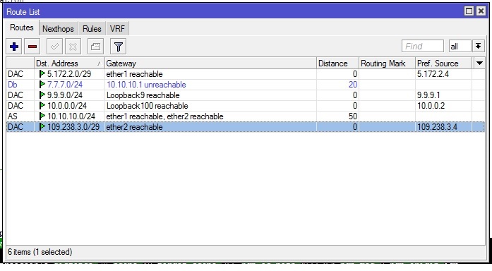

I’m testing in my LAB a load-balancing configuration between Cisco and Mikrotik RouterBoard1000 V6.10.

0 ADC dst-address=5.172.2.0/29 pref-src=5.172.2.4 gateway=ether1 gateway-status=ether1 reachable distance=0 scope=10
1 Db dst-address=7.7.7.0/24 gateway=10.10.10.1 gateway-status=10.10.10.1 unreachable distance=20 scope=40 target-scope=255 bgp-as-path=“65535” bgp-med=0 bgp-origin=igp received-from=peer1
2 ADC dst-address=9.9.9.0/24 pref-src=9.9.9.1 gateway=Loopback9 gateway-status=Loopback9 reachable distance=0 scope=10
3 ADC dst-address=10.0.0.0/24 pref-src=10.0.0.2 gateway=Loopback100 gateway-status=Loopback100 reachable distance=0 scope=10
4 A S dst-address=10.10.10.0/24 gateway=ether1,ether2 gateway-status=ether1 reachable,ether2 reachable distance=50 scope=10 target-scope=30
5 ADC dst-address=109.238.3.0/29 pref-src=109.238.3.4 gateway=ether2 gateway-status=ether2 reachable distance=0 scope=10

But on mikrotik i can’t ping the subent 7.7.7.0/24 because the gateway is unreachable (see the attachement)
I tried ti change the SCOPE and applied a filter but i have the same situation.

something wired about Your 10.10.10.0/24 subnet. ITS reacheble on two Interfaces. ITs seems like mikrotik cant do a ping/arp to 10.10.10.1 (but it should work, since bgp is established?)
If you put the route 7.x.x.x manualy. does it get reachible?
Most likely that if you manage to solve that 10.10.10.0/24 connected route problem (bug?) than you’re good. Have tried a reboot on MT?
