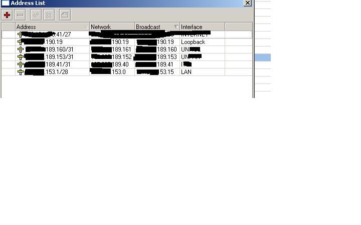

Cisco have loopback — and I put this loopback at interface bridge … put IP Addres loopback with x.x.x.x/32 .. with this condition I dont have any BGP Routing active… there are in DB only not IN DAB but If change loopback Address with x.x.x.x/24 All Routing will be Active but theres make some problem because theres any node (router) have a prefix from me or they have routing tables with my loopback address. so in this case make looping in network.

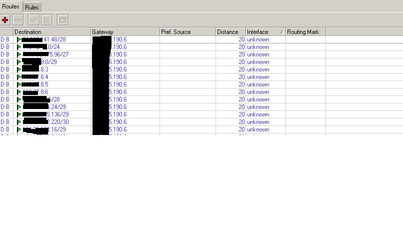

are you trying to say when you receive the routes the gateway isn’t right ? you can run BGP on loopback without problems I believe.

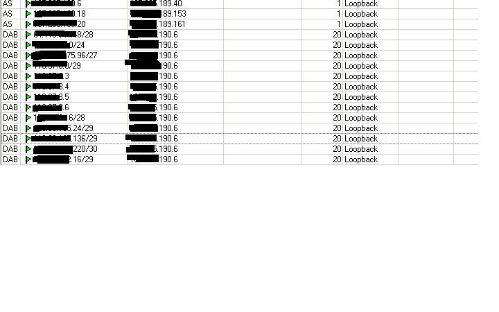

think all setting is corect but i route list they have unknow interface … (prefix loopback x.x.x.x/32)
but if I change prefix loopback will be x.x.x.x/24 in route list interface to be loopback and all routing Active
but theres some problem in this case …
is .190.6 the gateway these should be using to send traffic outbound? You probably need /routing filter to set-next-hop to the correct IP so when you receive routes the right gateway gets used.
The x.x.190.6 is the loopback IP with prefix x.x.x.x/32 all interface have IP point to point and they have
I think theres is no default gateway but …

theres 3 loopback
A. x.x.190.6
B x.x.190.20
C. x.x.190.18
and my loopback addres x.x.190.19
so x.x.190.6 is loopback from A, I dont screnshot all routing tables cause theres 354 routing tables in this netwokr
so my BGP instant is my AS number and router id x.x.190.19
