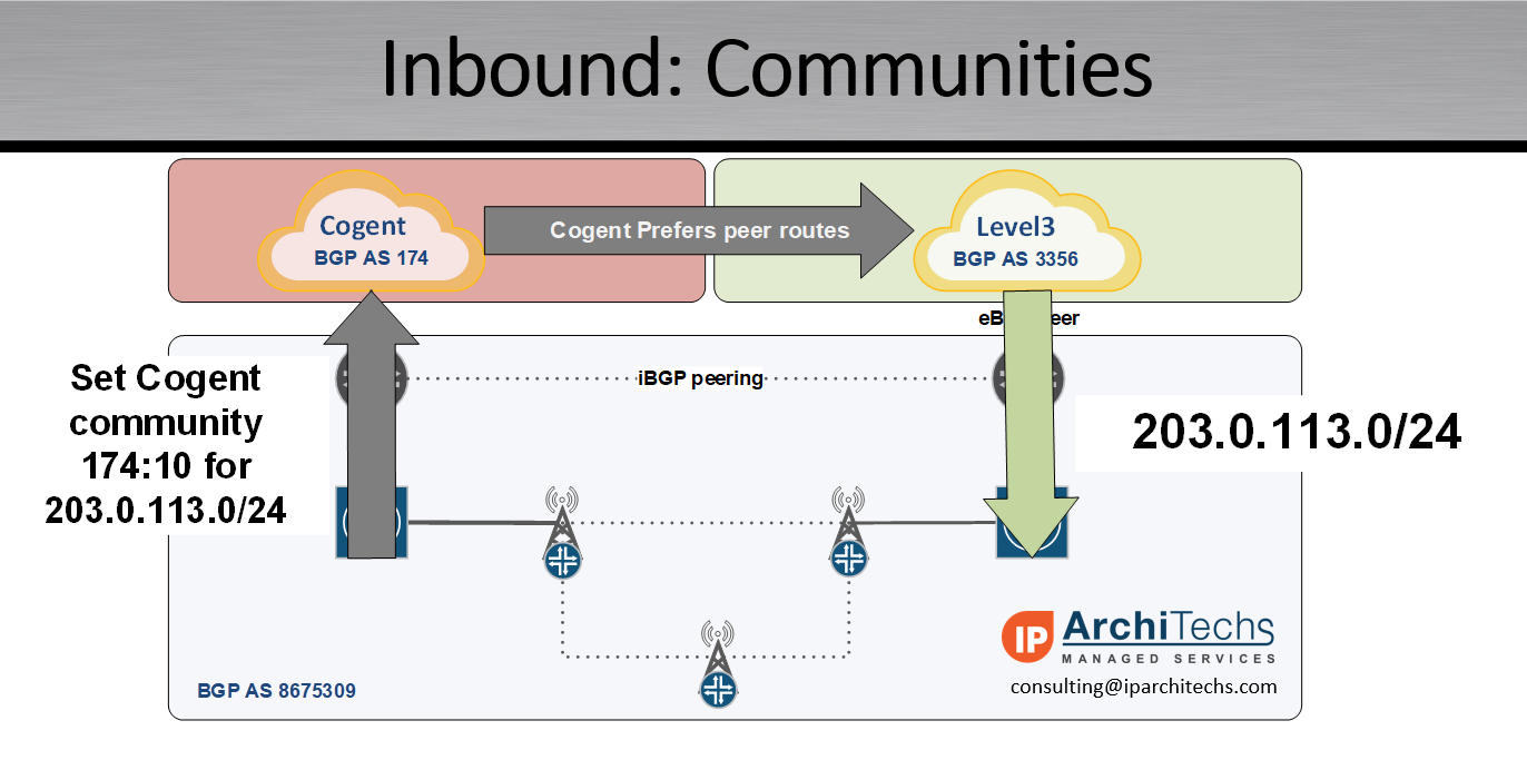

Prepending doesn’t work very well these days so i’d choose another strategy.
If your ISPs support communities and most large ISPs do, then you can set communities on your routes to either prioritize or deprioritize them via a specific peer. You can also split the prefixes up and advertise specific routes and an aggregate out each peer to influence the traffic.
Here is an example from a presentation I did on BGP Traffic engineering
