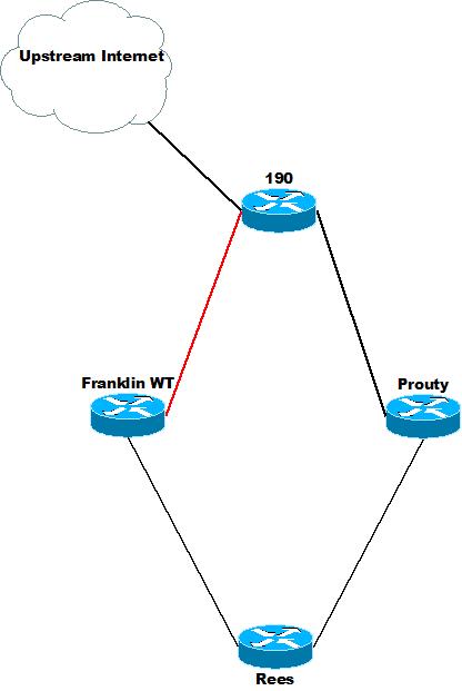

I am trying a lab setup to mimic some of the routers we have in the field. We like the idea of using eBGP on top of OSPF to get ECMP across our links and still be able to send traffic the direction we want using weights and local pref. The problem I’m looking at is based on these 4 routers:
The link between Rees and Prouty is an old an fairly slow link that we want to run just for backup purposes. So using just BGP weight, we have cost it out and forced traffic around the other side through Franklin WT. The problem I’m running into is if the link between 190 and Franklin fails, multihop keeps the BGP session live and sends traffic to Rees. This creates a loop because Rees says the default route is still in Franklin because Franklin didn’t drop the session with 190 thanks to multihop.
Is there a way to limit how far the multihop goes or just a way to keep this loop from happening?

Is there any BGP/OSPF Wizardry that would fix this instead of just moving it to the routing IPs to mitigate this issue on these sites?
eBGP on top of OSPF? ECMP without redundant links (you stated that Rees-Prouty is a backup route)?
No idea what are you doing.
