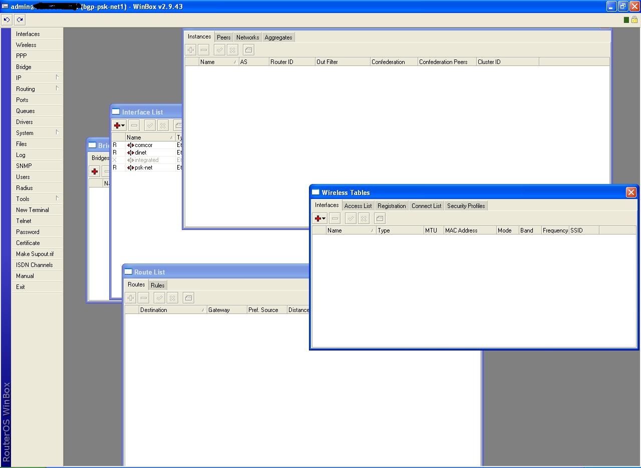

But i have any problem, i have 2 BGP instanses and piriodicly my routing table and all other (Firewall rules) is cleared forwarding do not work, bgp sessions is no longer connected.
/routing bgp peer print - show me at this time clear list
when i’m reboot the system - all is good and work.
That’s the routing crashing : ) I haven’t had good luck with 2.9.43 BGP routing-test yet. I am still using .26 since it’s been stable for us. Afraid to upgrade production routers that are working. There were quite a few versions we tested that just worked horribly and would spin out of control like your above screenshot.
