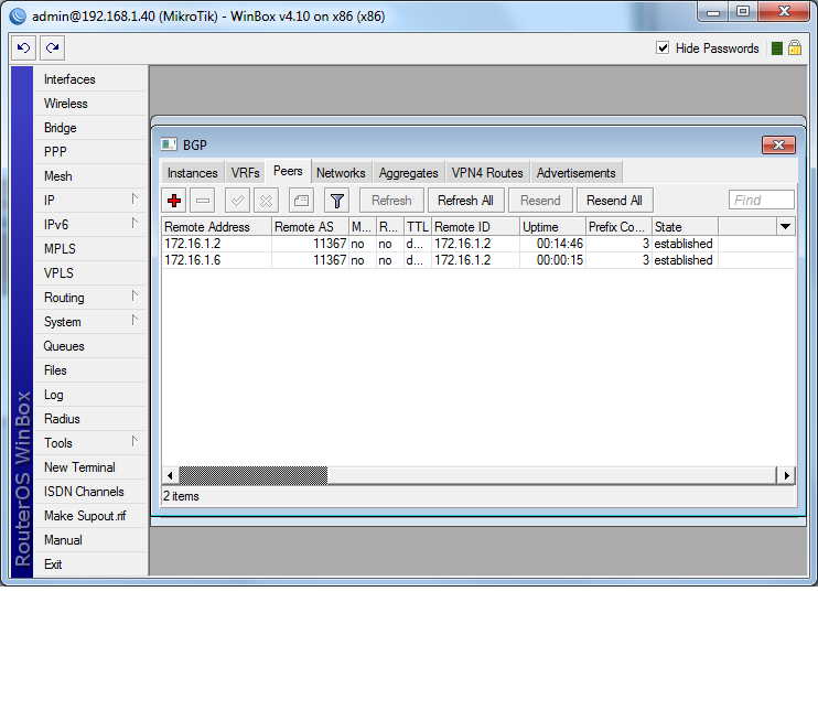

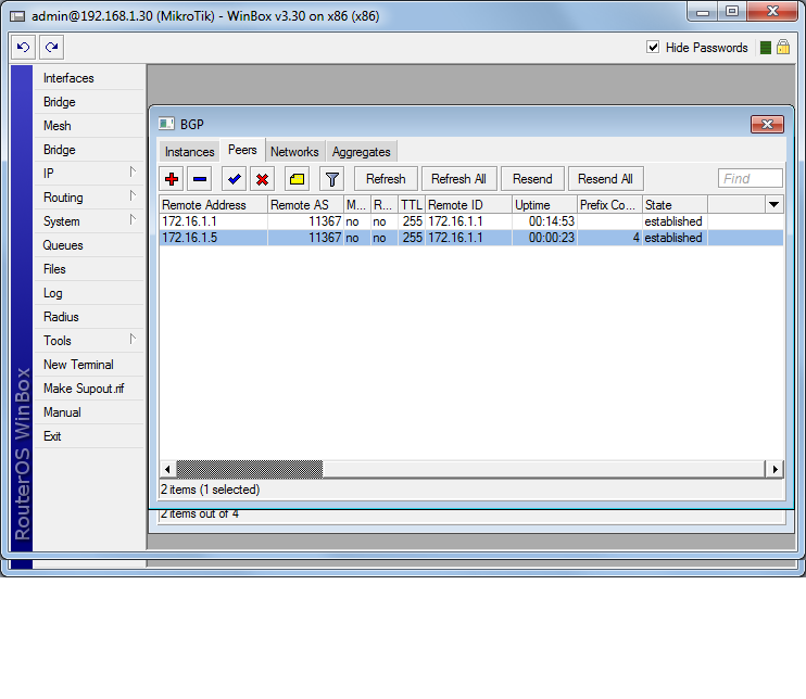

I have a problem with Mikrotik RoS 3 (3.30 and 3.28). Using version 4 ot seems to work fine.
The setup is very simple, I am using BGP to provide fail-over between two directly Mikrotiks.
The problem is that when the Mikrotik version 3 establishes the second BGP session the first BGP
session looses all the prefixes it had for no reason. However on the Mikrotik version 4 it correctly
keeps the prefixes for both sessions.
I have attached a screenshot of both Mikrotik’s.
