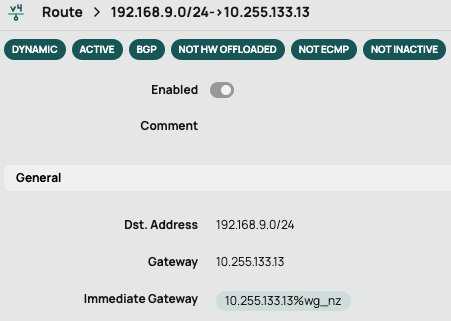

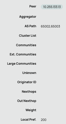

However…“NZ Hub” send traffic to “Bell” via “NZ” - a path that has 2 AS’ and should be more costly ?
I have read somewhere that AS PATH is number 4 on the path selection - how do I change that however ?
See the attachments for screenshots of the BGP Path on “NZ Hub”. The routing table has the other paths however, including a single hop path which is what I would like it to prefer.

maybe other routes local-pref is lower?
again a guessing games via screenshots
Dang it - found the session with the higher LP (I also thought the default was 200, but no, it’s 100)
