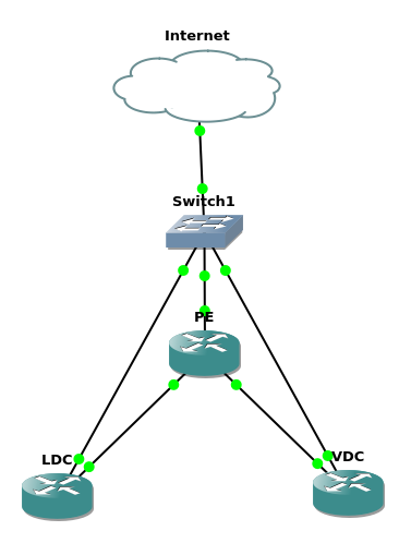

Please see attached picture.
I am having the below issue and suspect that I need to use route maps but just want to make sure that I am following the correct way here
(Please ignore the switch, it is for my loop back interface because this is simulated in GNS3):
From the router PE AS65100 I have a peer to LDC AS65199 and VDC AS65199.
LDC is my Primary with a weight of 200, VDC weight of 100 configured on router PE on the in filters.
I am also prepeding the AS two times from VDC to PE for the routes advertised.
When LDC fails and becomes available again the route is not selected as the Primary. I have tried adding local pref but still no luck. Obviously the next hop is not available on LDC but how do I go about getting it to always choose the LDC when available.
You seem to have multiple instances of BGP, see below. BGP weights, etc will not work between instances i.e.:
/routing bgp instance
set default disabled=yes
add as=65100 name=LDC router-id=10.15.155.2
add as=65100 name=VDC router-id=10.15.155.6
Change this to be in the same instance, i.e. default, test and feedback
