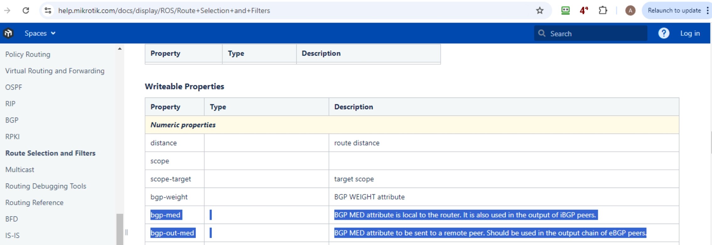

According to https://help.mikrotik.com/docs/display/ROS/Route+Selection+and+Filters we should use
set bgp-med
for ibgp, but it does not work either

bgp-out-med…
set bgp-out-med for eBGP.
set bgp-med for iBGP.
That's according to mikrotik user guide here
Btw I tried both for iBGP and doesn't work at all
