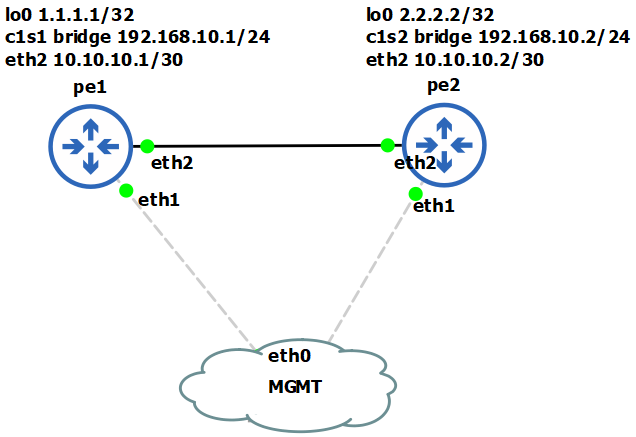

I’ve been banging my head with this for couple of days any help would be greatly appreciated, let’s say we have a basic network topology like below
there is OSPF proces running for IGP adverising loopback addresses and 10.10.10.0/30 network, there is also BGP signalled VPLS on bridge interface simulating CE routers. VPLS works fine as long as BGP peer’s address are addresses of physical interfaces eth2 on other sides of the link, the moment i change BGP peer to loopback address and update source to lo0 interfaces the VPLS stops working, despite BGP peering being established. I can succesfully ping every address on both sides and see bgp injected routes in routing tables, What’s the missing factor in play here, why does the VPLS stop working ?
