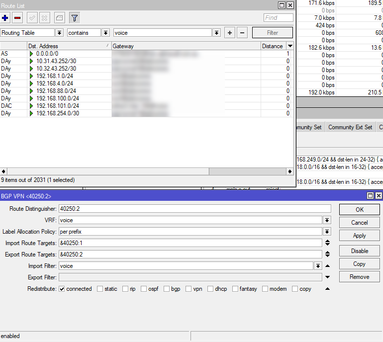

When trying to add export filters to a VRF/VPN Instance in Routing > BGP > VPN, all routes belonging to ‘Copy’ disappear from the routing table, leaving only Connected / Static, etc.
Is there a specific way in ROSv7 to achieve route filtering from within a VRF without making the Copied routes (from LDP) disappear?

Refer Images
:: Without Export Filter
:: With Export Filter

So to clarify, you add export chain and locally on this router routes from VRF table disappear?
Yes, that is correct. This happens regardless of the contents of the route filter, [which could have an {accept;} or {reject;}] but in spite of this, the export filter should not have any effect on the route table of the same router.
As soon as i add an export filter, all copy routes (as denoted by the ‘y’ flag are removed from the VRF). The VPNv4 routes however are not removed from the main route table and can be located via /routing/route print.

To folllow up; and this might be nothing, i have noticed under Routing > BGP > Connection, when selecting input / output filters, the dropdown list actually displays the entries created in Routing > Filters > Rule.
If i attempt to pick from the dropdown list for input/output filter under Routing > BGP > VPN > , the list is empty.
It does, however, return a list from items set in Routing > Filter > Select Rule. Although i am not sure of the use case of ‘select rule’.
I’ve since discovered that the VRF Export Filter facility expects to use rules created in Routing > Filter > Rule Set.
I’ve tested this functionality and it ‘appears’ to work although i can’t speak for the reliability of it as i only have 1 of 7 VRF’s working using this method. I don’t know why the other VRF’s aren’t working the same as in my test VRF.
If i try to create a rule set in Winbox, most of the time the rule i create or modify will wind up becoming ‘invalid’. I have defaulted to using CLI to do create / modify.
What I’ve also noted during this testing is that the import filter (as defined in BGP > VPN) does absolutely nothing. In-fact if I want to filter routes coming into the VRF, i can achieve this by placing the specific filter on the rule linked to the ‘export’ rule set.
