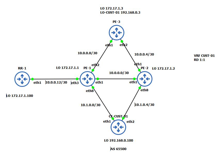

This topic how to produce the problem.
this the topology made with GNS3 lab.
CE advertise it’s loopback ip 192.168.0.100 to PE1 & PE2 with diffrent path length, hope that short bgp_path will be choosen as we can see in PE3
try this steps:
  1. After CE rebooted everything looks fine. from PE3 we can see 192.168.0.100 with shorted path has been selected.
  2. After that try to disable peer PE-1 from CE, then we can see from PE3 that 192.168.0.100 with longest path has been selected
    3.Then try to enable again peer PE-1 from CE, then the problem happen, from PE3 we can still see 192.168.0.100 with longest path keep selected.
    4.To make sure now you can disable peer PE-2 from CE, now from PE3 we can see 192.168.0.100 with shorted path has been selected.
    5.Then try to enable peer PE-2 again from CE and from PE3 we can see 192.168.0.100 with shorted path still selected.
Problem happen exactly i explain at point 3 after prefix with longest path selected it wont come back to shorted path until we remove prefix with longest path from routing table.
