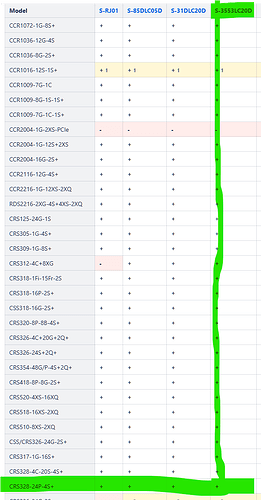

I'm thinking about using a fiber between two buildings (~ 150m). My plan is to install a CRS328-24P-4S+RM in each building.
I've discovered Mikrotik S-3553LC20D modules. If I'm not mistaken, this kit is a pair of SFP modules to use with a single mode/simplex fiber.
Can I safely use this S-3553LC20D in CRS328-24P-4S+RM as kit's datasheet lists several Mikrotik routers but doesn't explicitly list any switch ?
Best regards
It's listed as compatible in the documentation.
I'm sorry but I'm not seeing in referenced link any BiDi SFP/SFP+ module (Gigabit speed over a single fiber, using one wavelength in one direction and a different in the opposite one).
Shall I understand a Mikrotik switch can't connect to "simplex" fiber or am I missing something ?

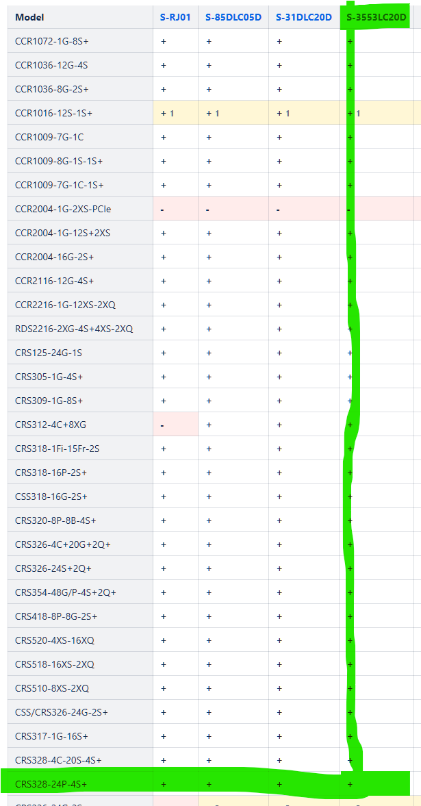

The combination of S-3553LC20D and CRS328-24P-4S+RM is shown as compatible on that page. "+" means they should work without limitations...
Thank you very much for correcting me.
The previous post is a reference to this:
https://mikrotik.com/product/S-3553LC20D
