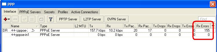

i have the same problem :frowning:
and i saw the [RX Errors] begin to increase as pic attached

hello again
i use both wire and wireless
when the ping stop and service stop
i watch this RX Errors increase
when ping and service back the RX Errors have no change
i use the same setting of you
i hope somebody help us…
