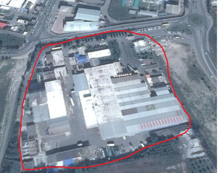

this is the area
this is the area
Can you send me google maps link of your location?
the location is not important, the choice of the radio to cover the whole area is important. i get confused with so many radios. what is the best choice?
I recommend you, using basebox2 with 6dBi omni antennas.
