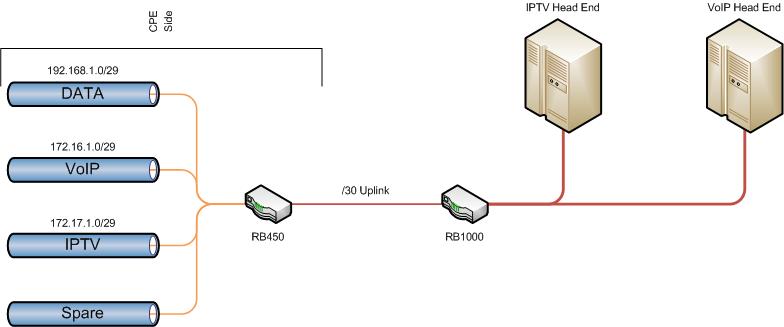

I cannot seem to have both the multicast, as well as routing[-test] packages installed on a Mikrotik? Is this by design? How would I be able to obtain both OSPF as well as Multicast support?
I am looking at deploying tripple play services to roughly 250 customers (initially), and want to make use of MT naturally to do so - especially on the customer side. My problem is that IPTV relies extensively on Multicast, and IGMP subscriptions and the like (we are looking at about 600mbit/s of IPTV traffic, therefore, Multicast becomes critical to reduce the traffic on the infrastructure). To ease routing, I was thinking of OSPF on the CPE in order to advertise the adresses in use at the CPE, instead of having to go enter 750 odd static routes myself.
Would MT allow for Multicast subscriptions, without the need of the Multicast packages in this scenario? The /30 uplink would be on a seperated VLAN, operating on Cisco 2960 and 3560 switches. My Core Routers would thus run 250 VLANs on a trunk interface connected to the switches, and the core routers would distribute IP data via OSPF / Static routes. I’m really not sure how the Multicast would be dealt with in this scenario?

hm… VLANs?.. I think, for multicast you should use different VLAN, because in ‘vlan per IP’ (or 'interface per user, that is the same) setup there’s practically no difference between multicast and unicast

The problem is that whilst there is 600mbit/s of broadcast from the IPTV Head End, naturally, on the CPE side they only receive what they watch. Now, given multiple TVs per home, what happens when 2 TVs watch two different streams? Then I basically would need say, 2 x Multicast subscriptions to different CPEs for Channel 1, and 1 x Multicast Subscription on Channel 2.
I’m unsure how Mikrotik would handle the IGMP subscriptions on the Core Router without the Multicast package, and I can’t run both routing and Multicast packages on the same routers… :frowning:

Also just need PIM proxy at the CPE side… At the head-end side, the traffic won’t even go through the RB1000. The switch will manage all the IGMP subscriptions internally across the multiple VLAN interfaces as far as I understand the Cisco documentation. This will only therefore become a issue when I want to route Multicast to other sites, which means a Point-to-Point connection between two or more core routers, or where multiple clusters of switches are not connected to each other.

You can use routing and multicast package togather, if you want to use routing-test, you wont be able to use multicast package. This is true for version 3. if you need features from routing-test and you want to use multicast package your only option is to use 4.0beta at this point in time.
Also - router have to be aware of multicast to forward multicast packages, or you have create tunnel to connect two multicast isles together. Also, IPM-SM is only needed between source and RP of multicast group, if clients wont broadcast any multicast streams (or you don’t want to allow them to) you should set up IGMP-proxy as it is straight forward for simple implementations (star scheme, for example).

Finally a straight answer. Tested and confirmed on 3.23 and 3.24. Not sure why this hasn’t been done before though, my own stupidity…
IGMP-Proxy with one uplink and 4 downlink (RB450G) is all that is required, and perfect for our needs yes. Granted, we still need to see how it will work out in production…
Thanks for clearing this up Janisk.
