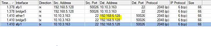

so i’m doing packet sniffer again, here’s a snapshot of the first packets.
i highlighted the reverse nmap from 192.168.5.128 to 192.168.6.128.
this is done automatically by mtik i assume on bridge dst-nat.
is this the one that would get missed if fasttrack was enabled?
i can’t quite tell what it would be because packet sniffer turn off fasttrack, so how does one debug fasttrack?
