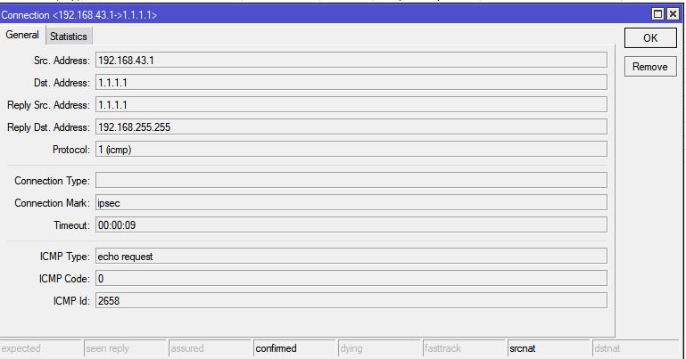

I’ve successfully implemented the src-nat to 127.0.0.1, which drops packets once the dynamic mode-config src-nat rule dissapears once the vpn is down, but if I try using src-nat to let’s say 192.168.255.255, I can’t make it work. The mangle to catch this traffic originating from the new source “192.168.255.255” doesn’t work because the src-nat takes place in the postrouting chain and no further routing manipulation can be done there.

No packets are catched by moving the mangle rule in all chains.
The src-nat does it’s job after the VPN is down, can be seen in the fw connections:
