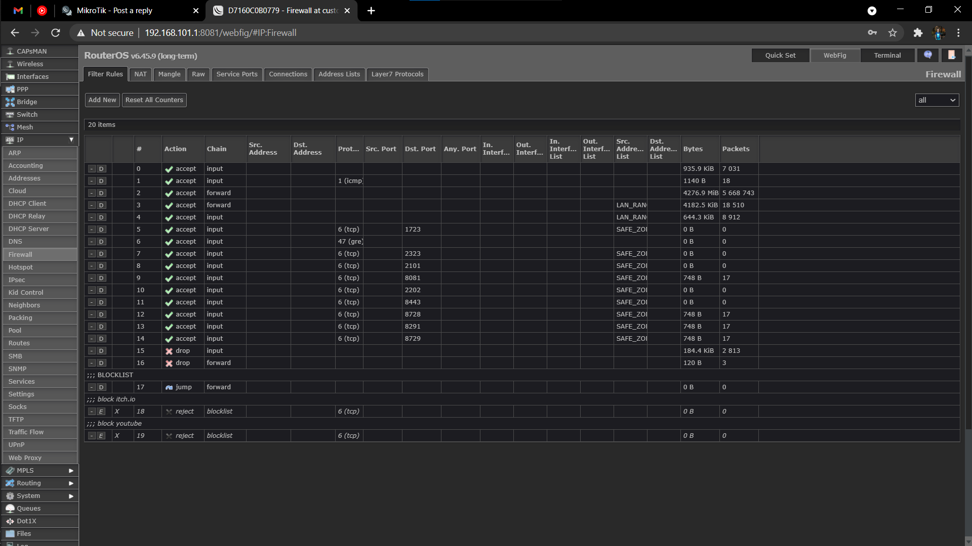

Thanks for the pointers! I’ve entered the commands exactly as you gave them, both for YouTube and for itch.io, and unfortunately both of them are not being blocked at all. I’ve attached a screenshot of the firewall page; please let me know if there’s any information you need.

first, upgrade to 6.47.9,
second, the rules on example are (X) disabled (right choice on examples)
must be activated for work, but probably you also do not have disabled fasttrack

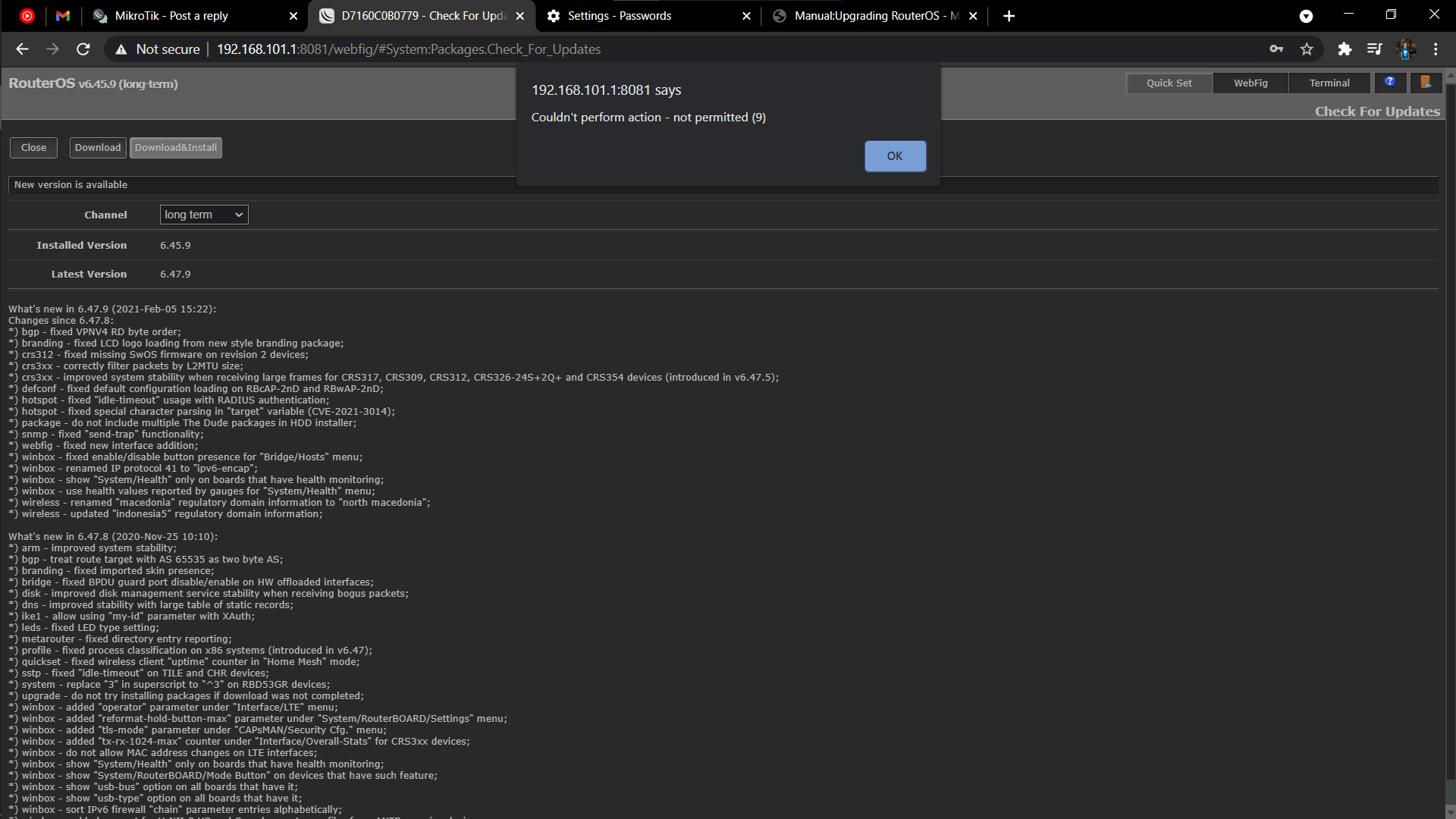

Thanks for your help! I have now enabled those two rules which were disabled before. Also, fasttrack has been disabled. However, I am having trouble updating RouterOS to 6.47.9, as when I try to click ‘Download&Install’ in the relevant menu I get the error ‘Couldn’t perform action - not permitted (9)’. My guess is that this is some restriction from my ISP. Do I have to update to the latest version in order for this filtering to work correctly?
Anyway, the filtering is not working yet as I can still access YouTube and itch.io.

In the example that Normis gave, the new rule for BLOCKLIST in the forward firewall has to be moved to the top of the forward rules.
When it is below the “accept established/related” rule it will not work.
I advise you to keep the forward rules together, so move the two forward rules that are between input rules down below the BLOCKLIST (jump) rule.
Thanks @pe1chl! It seems to be working now.
