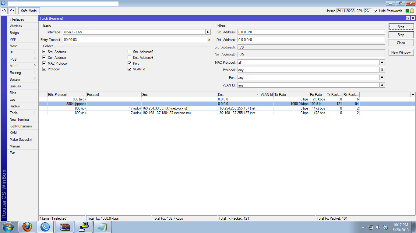

Dear Sir,
I have customer running on PPPoE but customer are connecting threw PPPoE username and password & found that in tourch 0.0.0.0 with traffic approx 2Mbps + due to the same customer are getting error Connecting Throw WAN MiniPort (678)
can you advice how i drop this 0.0.0.0 traffic
NIshit
The 0.0.0.0 traffic could be PPPoE session traffic. Which MAC protocol does it show?
Dear Sir,
it is not showing any protocol also can you can see attached screen shot
Nshit
The 8864 traffic looks like PPPoE session traffic. From your original question I can’t tell what seems unusual about it.
Dear Sir,
does this traffic is normal traffic ?? As my customer are getting all time WAN miniport 678 error in case of connecting threw PPPoE Client
Nishit
