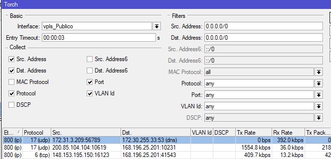

Hi, I’m having a terrible maze finding a solution to stop and block traffic on my vpls network.
In picture you can see traffic from 172.31.3.209 to 172.30.255.33 on DNS port, It seems to be boggons IP but can’t find a way to stop it.
If any one could give me a guide to achive what i’m looking for..
